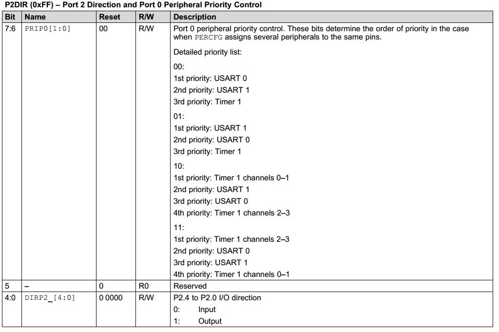

Hai,
                      I am using UART DMA to write and read from uart i have configured
My code:
void Uart_DMAInit(void)

But
in _hal_dma_uart.c
static void HalUARTInitDMA(void)
halDMADesc_t *ch;
P2DIR &= ~P2DIR_PRIPO;
P2DIR |= HAL_UART_PRIPO;    what does it refer to
#if (HAL_UART_DMA == 1)
PERCFG &= ~HAL_UART_PERCFG_BIT; // Set UART0 I/O to Alt. 1 location on P0.
#else
PERCFG |= HAL_UART_PERCFG_BIT; // Set UART1 I/O to Alt. 2 location on P1.
#endif
PxSEL |= HAL_UART_Px_RX_TX;
PxDIR |= 0x40;
// Enable Tx and Rx on P1.
ADCCFG &= ~HAL_UART_Px_RX_TX; // Make sure ADC doesnt use this.
UxCSR = CSR_MODE; // Mode is UART Mode.
UxUCR = UCR_FLUSH; // Flush it.
I want to configure to USART1 Port 1
i went through D112 Doc, configured accordingly, is there any other configurations to do more ..
