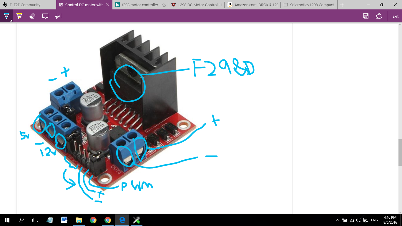

  • This is my hardware.
  • I don't mean CC2530 HW. I mean to know what HW interface is used to control your DC motor?
  • I only have a motor with 2 wires sticking out. Can you suggest me a HW board to control it that is compatible with the CC2530?
  • I am not sure how to help you in this. It's off topic to this E2E forum.
  • This is my hardware to control a motor. It can handle 2amps and 5v-12v. It's a pretty common one.
  • Do you have specification of this HW?
  • Specifications:

    It's actually L298N and to the left of the PWM is actually forward and backwards pins for motor.

  • You have to check which PWM pin on your DC motor control module would control forward of moter and which PWM pin controls backward. Then, you can output two different PWM from two different pins on CC2530 to control it.
  • There is 3 pins per motor. You are talking about 2. I know what all the pins do. 1 goes backwards, 1 goes forward, and 1 controls the speed. How would I get the motor going forward or backwards?
  • From your descriptions, I think you have to set forward pin to high, backward pin to low and output PWM to PWM pin to make moter forward. Set backward pin to high, forward pin, and output PWM would make moter backward. Set forward and backward pin to low and don't output PWM would stop motor.

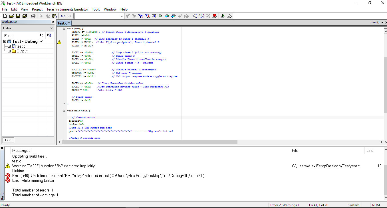

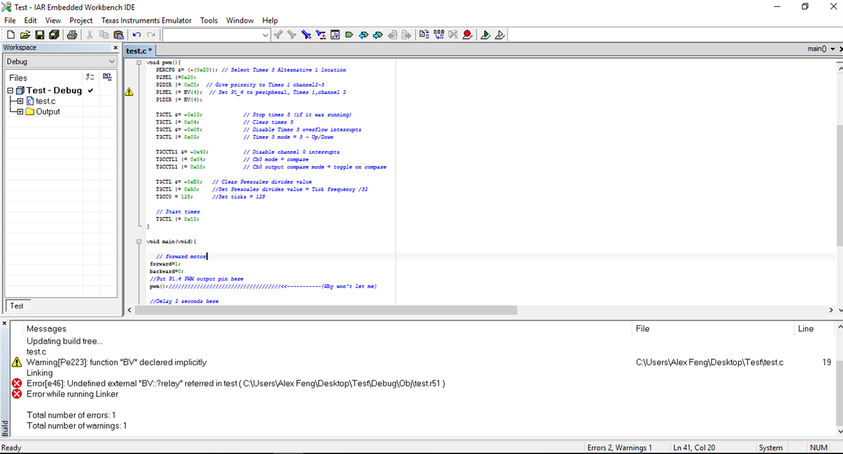

  • So I was able to translate the code into this. Does it seem right to you? The part, "//Put P1.4 PWM output pin here" ; Is this where I put the PWM code from the website you gave me?

  • 1. The code looks fine.
    2. Yes, you can use the PWM sample code from the link I gave you to output PWM on P1.4.

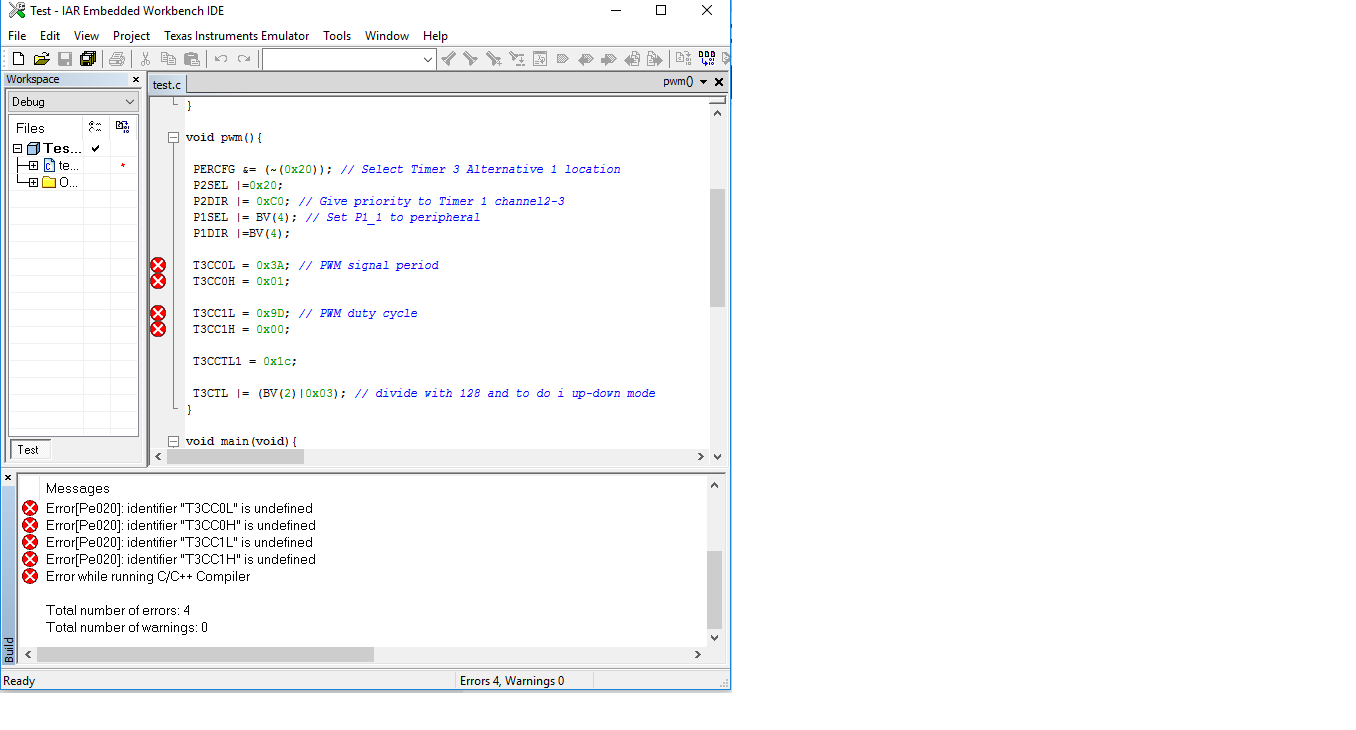

  • Why do I get this error whenever I call the pwm(); method?
  • Add "#define BV(n) (1 << (n))" in your main.c.

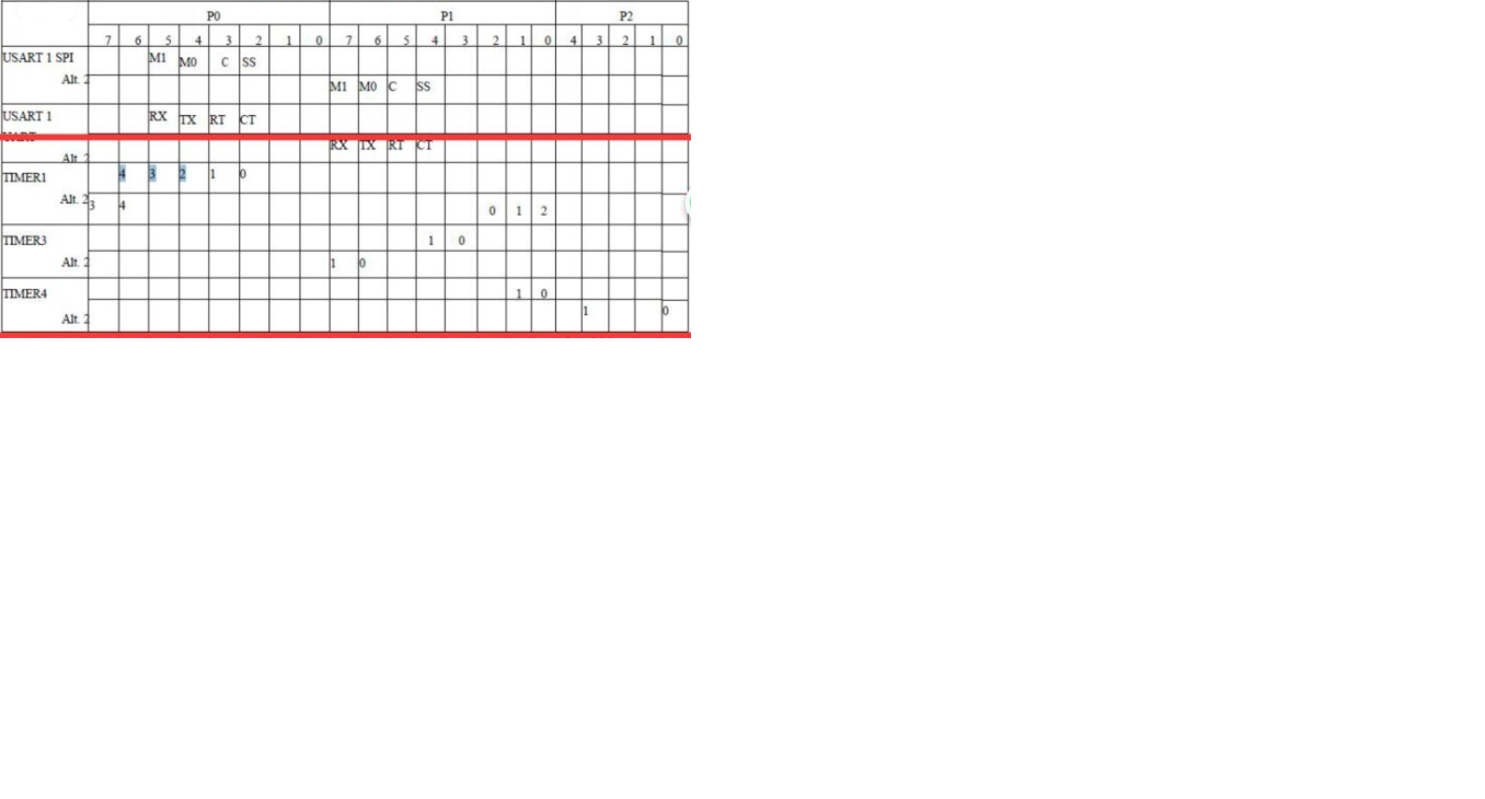

  • If you read CC2530 user guide, you will see P1SEL is to select peripheral function. The result of BV(4) is 0x10 so P1SEL |= BV(4) is to set P1.4 as peripheral function because you would use it as PWM. P1DIR is to set output so P1DIR |=BV(4) is to make P1.4 as output pin so it can output PWM. Frequency of PWM is controlled by T3CTL and T3CC0 which you can read user guide by yourself.

  • So after looking at the picture below, it looks like I do need to change the Timer to 3 for P1.4 and Timer 1 for P1.1.
    "Why does each pin require a different timer? What is a timer exactly?"
  • Yes, you are correct. I forgot to check this pin table first. There is several clocks in an IC and it is used for counting timing which is the most important to make everything work. A Timer is an HW design evolved from clock module to provide you a clock output so you can generate different clock signal such as PWM.
  • I tried changing the code to fit P1.4 at the same frequency and duty cycle as P1.1. However I'm not doing something right. Can you help me out with the code below?
