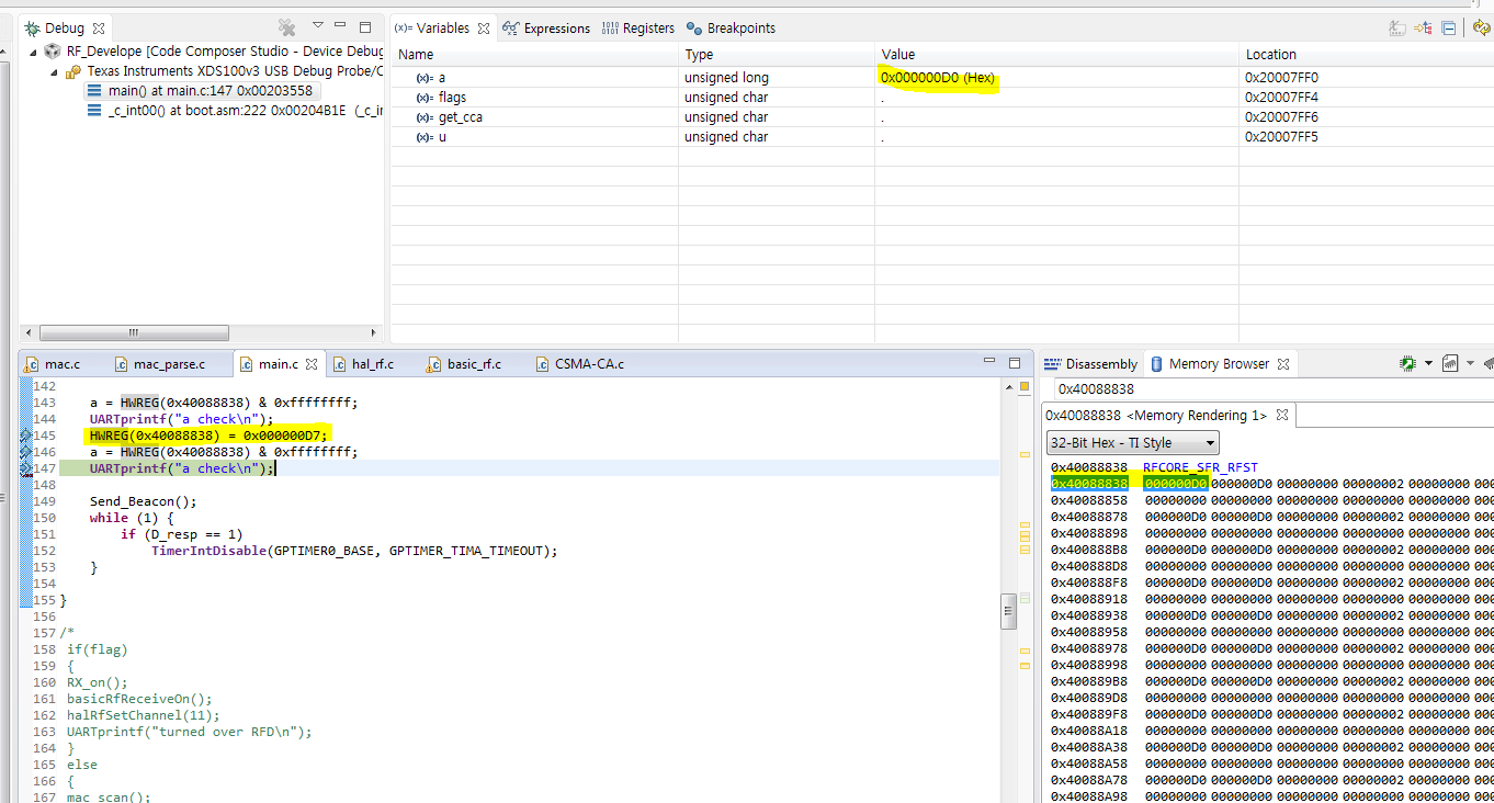

CC2538DK strobe value change.
CC2538DK board support strobe for various command.
As you see, there is an autoACK in RF transmission.

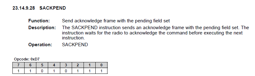

In the ACK frame, there is a bit for Frame Pending information.
User can change the Frame Pending information bit using strobe.
But As you see in the above pic, my command didn't work.
the value of RFST ins't change even use memory browser. ( the value immediatly returned.. in reset value..)
Is there any solution for this problem??
