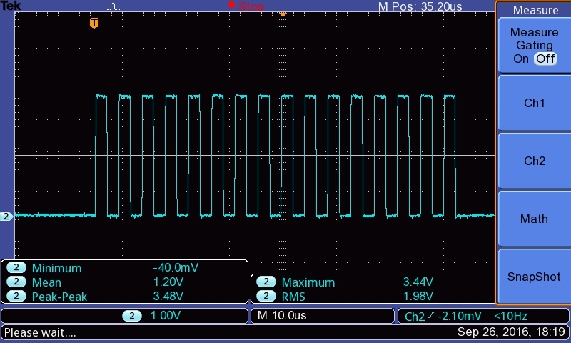

But the issue with this is,Clock signal is not generating on P1_5.
what can be the probable issue???

  • You only get SCLK signal when you do SPI write or read.

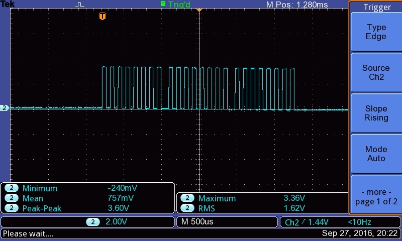

    while data transfer in SPI, i always get 16 cycles on SCLK pin but i should get 24 cycles on SCLK pin while data transfer.
    what modification should I do so that i can get 24 cycles on SCLK pin??
    DC

  • I only see you call XNV_SPI_TX(0x20), XNV_SPI_TX(0x56), and XNV_SPI_TX(0x78) which would only send 3 bytes, 0x20, 0x56, and 0x78 from SPI master.
  • for sending 3 bytes i should get 24 clock cycles on SCLK pin but I m getting only 16 clcock cycles on SCLK pin.
  • I suggest you to trace those SPI TX command line by line to see which one doesn't send SCLK.

  • I have tried everything but I always get maximum 16 clock cycles on SCLK pin while SPI transfer.
    I should get 24 clock cycles as per my requirement.
    IS there any limitation in cc2530 SPI??
    if not then plz help me to resolve the issue.

  • As I know, there is no limitation on SPI interface of CC2530. Have you debug step by step to know which SPI TX command doesn't send SCLK signal?
  • first two SPI TX command after SPI BEGIN always sends SCLK signal after two SPI TX command third SPI TX command does not send SCLK signal , i m getting why it is happening.

    I received correct data for sometime at slave but it started showing wrong data after some time.
    When I observed the clock cycles, I got 24 cycles, but still there is issue of corrupted data.
    Hence I see there is some issue with SPI. In sample apps, while communicating with LCD, they used byte by byte data sending mechanism. I tried same above by introducing MicroWait(t) function. Kindly help.
