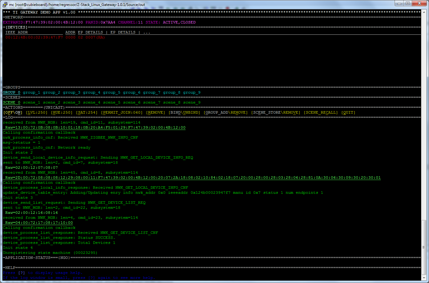

Hi. I succesfully started a z-stack linux gateway on arm device. Coordinator is a cc2530 board connected via spi.
Coordinator firmware is a Z-Stack Home 1.2.2a  ZNP compiled with preconfigured network key.
Gateway is started and demo app looks like this:
Then i'm trying to join another device (board: cc2530, project: SampleLight - EndDeviceCB).

But there is no any change at gateway part. No new device, no events in logs. I added NWK_GET_DEVICE_LIST_CNF call by user in demo app and it always return "Total Devices 1"
So what i'm doing wrong ?? How to debug this problem?
