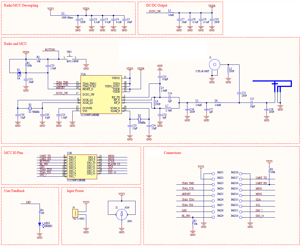

I am utilizing the bootloader functionality where I'm turning on the back door entry, and using DIO3 set to active high for entry.  I have an external 10k resistor pulling this pin low to set the normal state.  What I’m seeing is that when the CC2650 first powers on or gets a reset, DIO3 glitches high, putting it into bootloader mode.  I changed the pull down to 7.5k, and it seems to work as expected (boots from flash).  I’m a bit skeptical of blindly accepting this change, because I’m not confident that it solves the problem in all scenarios since I don’t know what’s causing the glitch in the first place.
The data sheet states that this pin is set to default input with no pull ups enabled.  So, what could be causing this?
Could anyone provide any insight into this?

  • Can you provide schematics for this part?
  • Here is the schematic of the relevant parts of my design.  It is essentially just a radio with connections to the outside world (PAD1 to PAD18).
  • Can you show what your BL_PIN connects to? If it is floating, I think 7.5K pull-down resistor should be fine.
  • This radio will be used in multiple products. Some that are a stand alone radio, where this nothing external is connected to PAD1-PAD18, hence the requirement for the pull down resistor R7 to set the state of the boot loader pin. What I'm really looking for is an explanation as to why the 10k pulldown doesn't work. Why do you say that the 7.5k pull down should be fine? Is there data to back this up?
  • Can someone from TI please help with this one?  The behavior of the MCU appears that directly out of reset the GPIOs are initialized with pull up resistors turned on for a few CPU cycles, which is contradictory to the reference manual.  I'd like to understand what the internal pull up resistor value range is so I can design my circuits adequately.  I can't seem to find this information in the data sheet.
  • It doesn't make sense that 7.5K pull-down resister works but 10K not. I suggest you to use multimeter to check your BL_PIN to see if there is any difference when you connect 7.5K and 10K pull-down resister.
