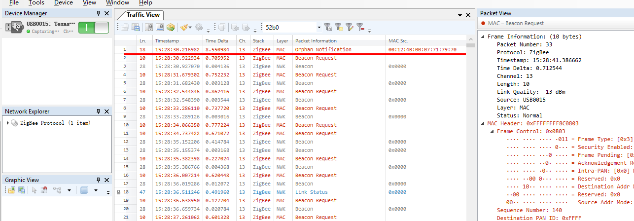

       step4:power on the coordinator, and then press the key , i saw the LED blink ,and  return state value is  ZSUCCESS
       but  i have  not seen anything  in  the ubiqua windows~~~~~
        Q1  :  is that mean coordinator  would not send out anything  while execute the  NLME_DirectJoinRequest()
        Step 5:
        when the end device power on,  it send  out a  orphan notification  then always send beacon request  and  could not  join the network。
         Q2  so  what is wrong of my test ?
