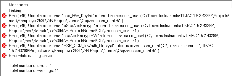

I want to use AES CCM service in sample project in TIMAC 1.5.2.43299 for CC2530, in particular, zaesccmDecryptAuth() function. I have included corresponding headers in application file msa.c:
#include "hal_aes.h"
#include "zaesccm_api.h"
but still get some linking errors
Is there some file missing in project? Or should I do some additional configuration?
  • I assume I need to include library macLibSec_cc2530-Banked.lib. Could somebody explain how to do it in IAR?
  • I did. As I understood for CC2420 CCM mechanism is implemented at HW level and for CC2530, which I am working on, I need to write additional SW. And seems library, which I mentioned above is designed for this purpose. But I am not able to use its API.
  • To solve the link issue, you have to add hal_aes.c and hal_ccm.c under \TIMAC 1.5.2.43299\Components\hal\target\CC2530USB to you project.

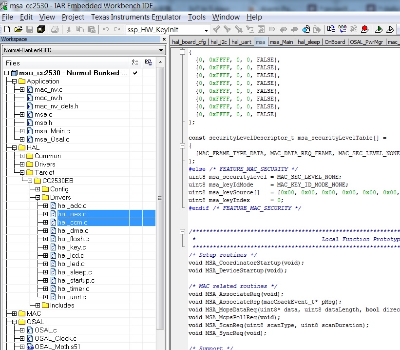

  • I mean to add them to project files like the following screen shot.
  • Thanks YiKai Chen (1482894).
    I also had to add usb_board_crf.h and usb_req.h files and change configuration of project to Banked for successful build.

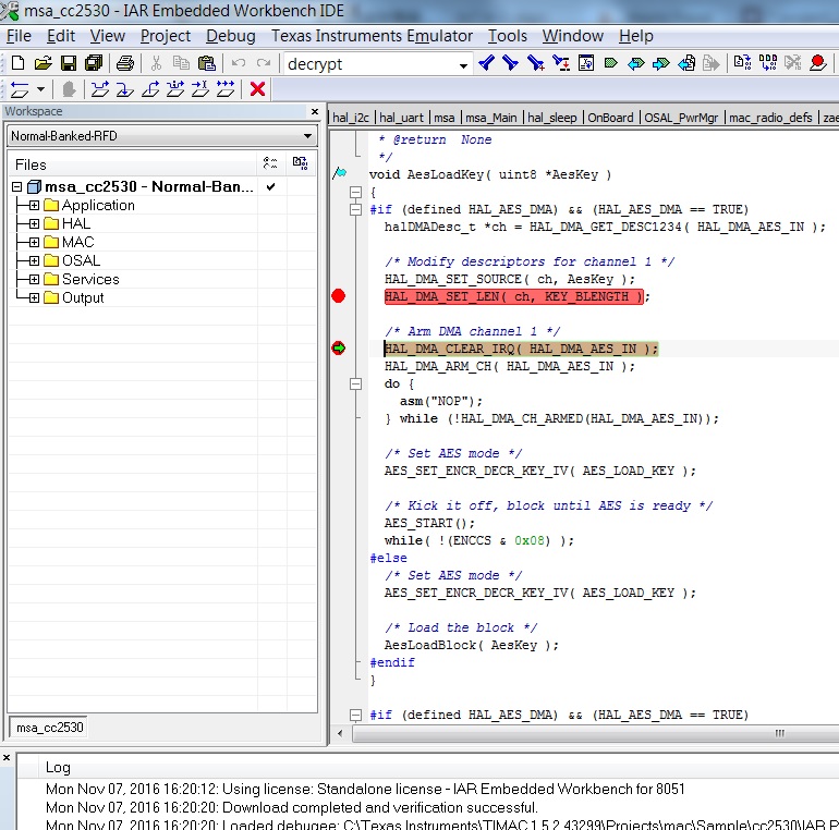

    Now when debugging I have issue with using zaesccmDecryptAuth() function.
    I added some code in msa.c for testing purposes:
    unsigned char decrypt = DECRYPT;
    unsigned char Mval = 4;
    unsigned char Nonce[13] = {0x00, 0x11, 0x22, 0x33, 0x44, 0x02, 0x30, 0xC2, 0x00, 0x00, 0x00, 0x7F, 0x05};
    unsigned char M[13] = {0xBC, 0xAD, 0x4A, 0x10, 0xD4, 0x0C, 0x48, 0xD8, 0xFB, 0x57, 0x14, 0x03, 0xA3};
    unsigned short len_m = 13;
    unsigned char A[13] = {0x20, 0xE8, 0x11, 0x00, 0x05, 0xC1, 0xE8, 0xC9, 0x05, 0x7F, 0x00, 0x00, 0x00};
    unsigned short len_a = 13;
    unsigned char AesKey[16] = {0x00, 0x11, 0x22, 0x33, 0x44, 0x55, 0x66, 0x77, 0x88, 0x99, 0xaa, 0xbb, 0xcc, 0xdd, 0xee, 0xff};
    unsigned char MAC[13] = {0x00, 0x11, 0x22, 0x33, 0x44, 0x55, 0x66, 0x77, 0x88, 0x99, 0xaa, 0xbb, 0xcc}; //{0x06, 0xF2, 0x2D, 0xFF};
    unsigned char ccmLVal = 2;
    unsigned char result = (unsigned char) zaesccmDecryptAuth(decrypt, Mval, Nonce, M, len_m, A, len_a, AesKey, MAC, ccmLVal);
    uint16 len = HalUARTWrite(HAL_UART_PORT_0, &result, 1);

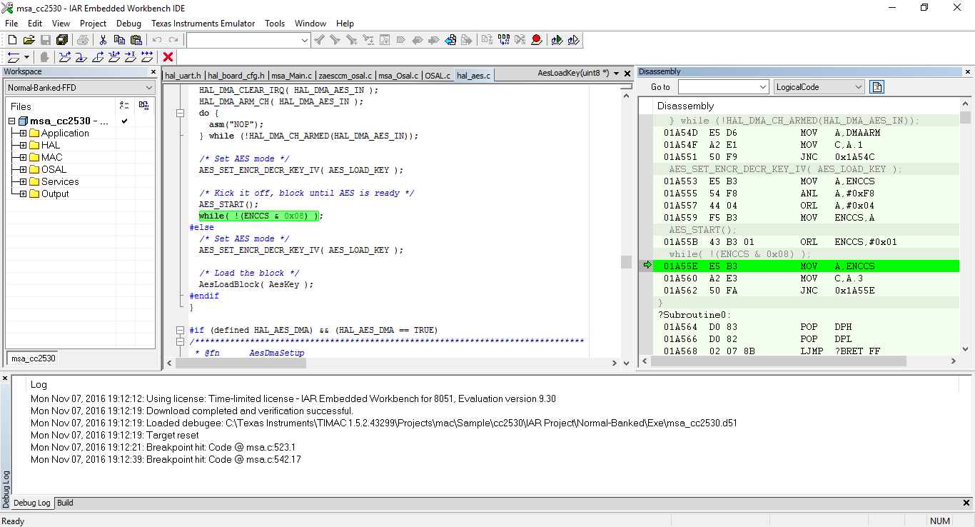

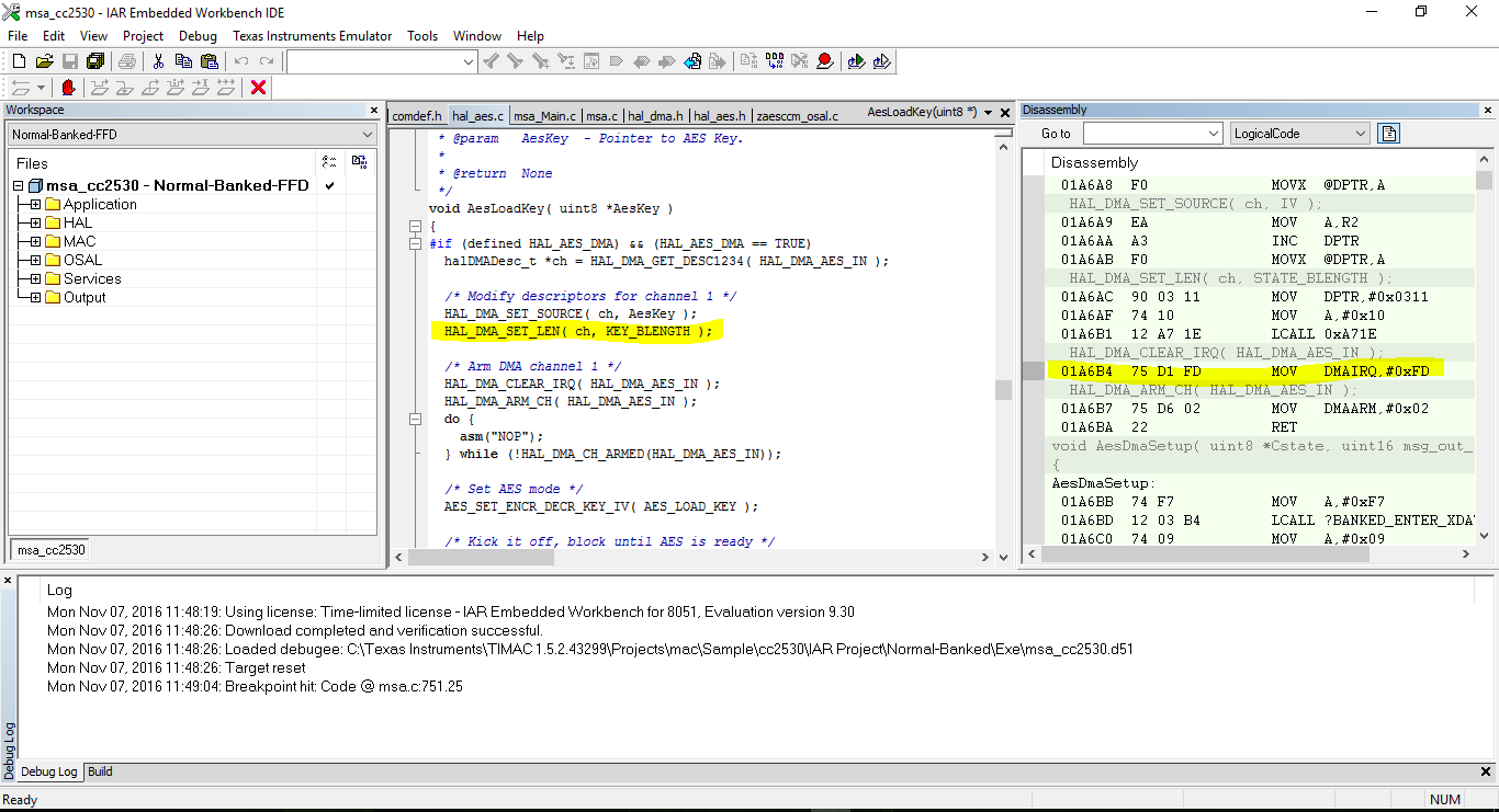

    ...and debug session is hanging after performing lines highlighted with yellow on screenshot below.
    Not sure how I can troubleshoot this.
  • I have no problem to step over that statement in IAR debug.

  • OK, I've installed 9.10.1. Now it stucks in deadloop in different place
  • I've seen this happen if the aes engine is not initialized with key and or IV/nonce before use. Make sure to initialize the aes engine as well as key and IV/nonce before EACH use.
  • You can add "HalAesInit();" before you call zaesccmDecryptAuth.
  • Thanks Brocklobsta (4737007)  and YiKai Chen (1482894).
    Adding HalAesInit() had help. And it seems important to place it just before calling zaesccmDecryptAuth(). Before I tried to add it to initialization section in msa_main.c and it didn't work.
