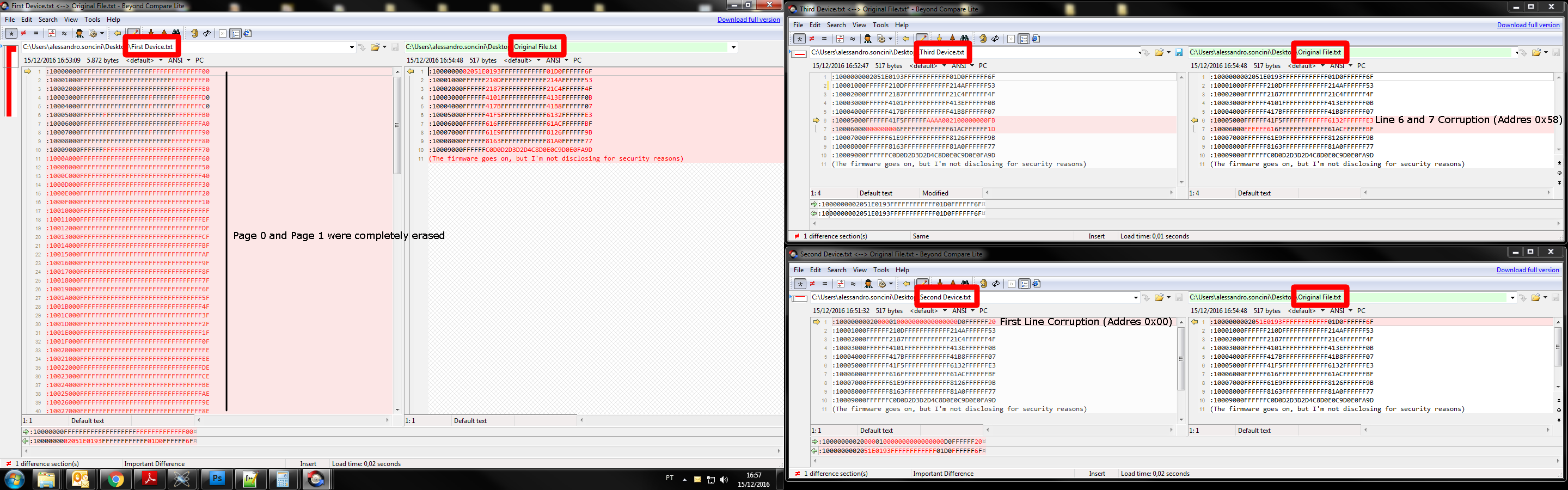

Problematic Device 01:
By analyzing the hex-file we could see that the first 2 pages were erased. The first 2048 bytes were displayed as 0xFF in the hex-file. So it will be 2048 NOPs until the first valid byte appears.
Here is the first line of the problematic hex-file:
:10000000 FFFFFFFFFFFFFFFFFFFFFFFFFFFFFFFF 00
And here is the first line of the golden hex-file:
:10000000 02051E0193FFFFFFFFFFFF01D0FFFFFF 6F
Problematic Device 02:
By analyzing the hex-file we could see that the 11 bytes of the 16bytes from the first line of the hex-file were different. Not just different, but the bytes were replaced by 0x00. So the first jump will point to address 0x0000.
:10000000 020000010000000000000000D0FFFFFF 20
And here is again the first line of the golden hex-file

  • Just now another product came up with the same problem.
    I really need some help here and I'm willing to disclose a lot of information and effort to investigate and eliminate this problem.
    I'll not stop posting here until I can solve this problem.
    So now I have 3 products that show the same problem.
    -The first one came up with page 0 and page 1 erased.
    -The second came up with 10 bytes corrupted in the first 16 address. The corruption is not sequencial. The first byte was ok, the second and third were corrupted (0x00) the fourth was ok.
    -The third came up with 12 bytes corrupted starting at address 0x58, this time, all sequential.
    I read the flash of each device using SmartRF Flash Programmer (Read flash into hex-file)
    I compared each corrupted Hex-file against the original Hex-file.
    The result is attached to this post and also available at the link below:
    i.imgsafe.org/2ea4140581.png

    -The only way the bootloader could ever write his own flash space would be by RAM corruption when setting the DMA address.
    What i think it's really weird is the fact that the flash write command only writes in blocks of 4 bytes and I'm getting sometimes 2 bytes corrupted and 2 bytes intact. As below:
    Original: 02 05 1E 01
    Corrupted: 02 00 00 01 (The value 0x02 is at the address 0x00 of the flash)
