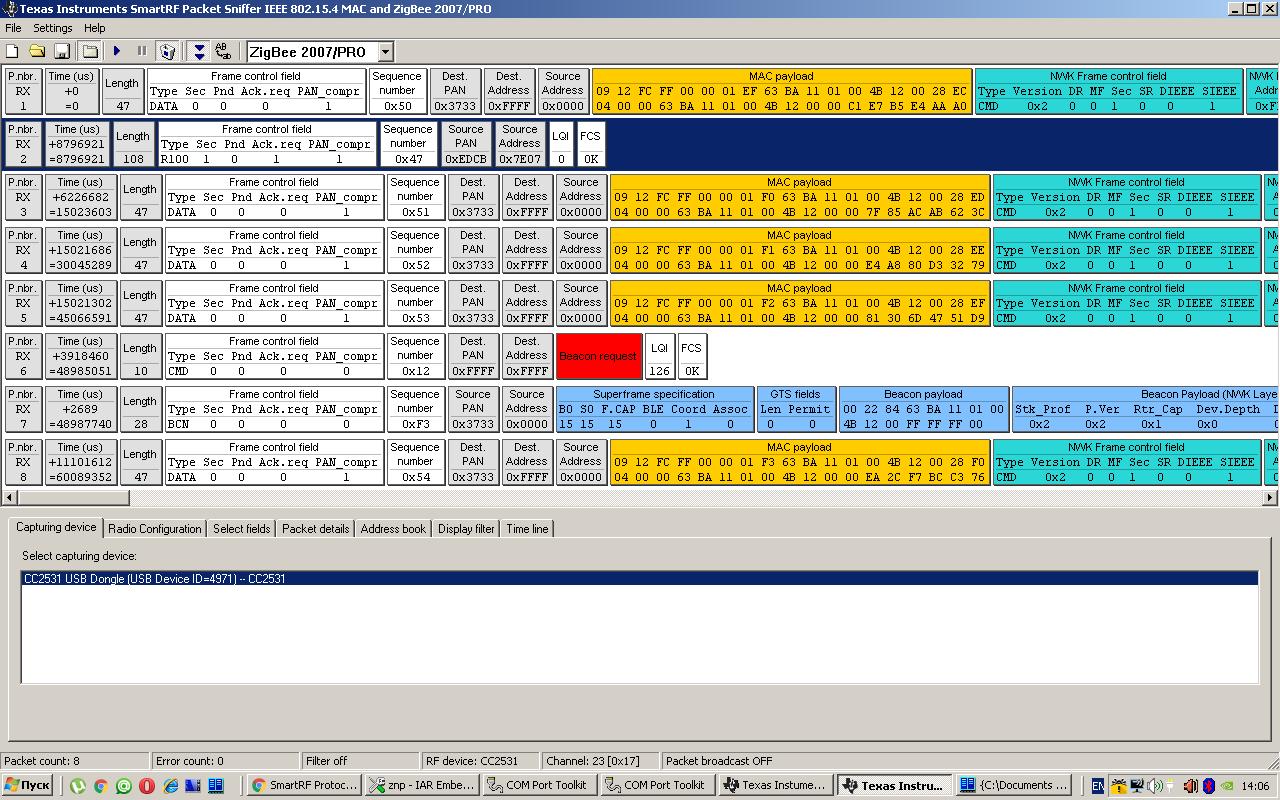

Second Problem - I can not build network.  I try to build network like prevision version ZNP (Send same command). But when I try build prevision network I build it without any security an TC was disable in compile.
When I try to build network now the TC is enable.  In sniffer I can see next

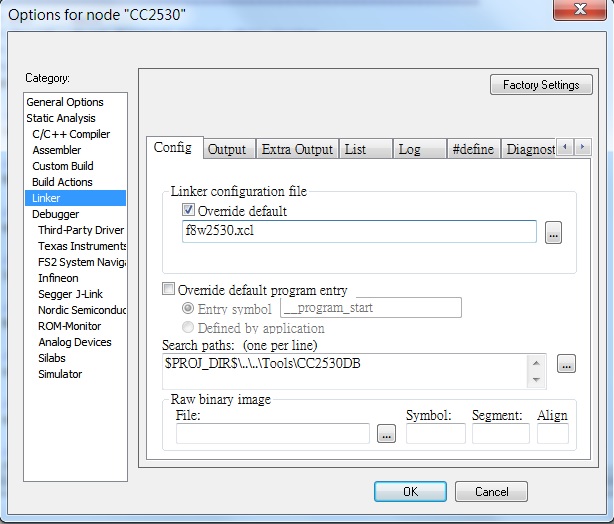

  • I test ZNP in Z-Stack 3.0 ProdHex and Debug projects. All work fine. I use attached script coordinator_light.zip in to do the test for your reference.
  • I think I made a little change to make ProdHex work. You should select f8w2530.xcl (under \Z-Stack 3.0.0\Projects\zstack\Tools\CC2530DB) instead of znp-prod.xcl (under \Z-Stack 3.0.0\Projects\zstack\ZNP\CC253x\tools) as "Linker configuration file".

  • When I set this f8w2530.xcl link scriptI get this error
    Fatal Error[e72]: Segment CRC_SHDW must be defined in a segment definition option (-Z, -b or -P)

  • Which IAR version do you use?
  • I use IAR 9.20. But i can to try 9.30
  • What can you speak about my start script?
  • 1. Yes, Please try IAR 9.30.
    2. I suggest you use the script I mentioned in previous post to make it work first.

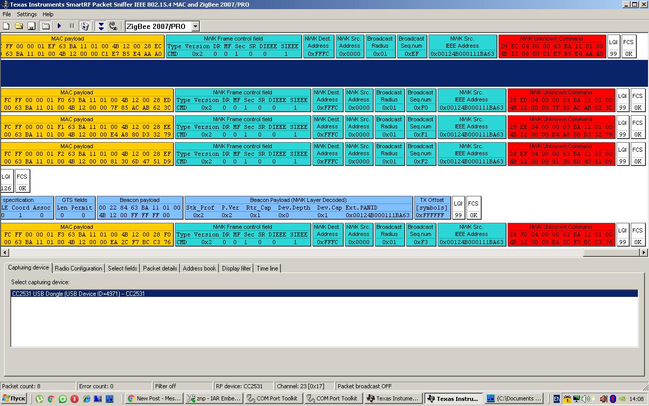

  • I try your scripts.  But nothing! The ZC  starts ok and ZR don't starts  it send Beacon request (I can see it in Sniffer)  Coordinator sen SuperFrame and it is all.  The Router Script infinity send Start_request  and get  ZDO_STATE_CHANGE_IND
    It is all.
  • You have to enable permit join on ZC to allow ZR to join.

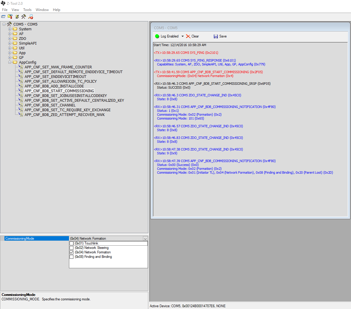

  • Hi Pavel,
    If you want to start a ZNP coordinator device, I would suggest to use the BDB commissioning methods defined by Z3.0 (see the 'Z-Stack Monitor and Test API' in section 3.13.1.5 for using the commissioning methods). This methods are already available in Z-Tool.
    The steps that you have to make on a ZNP coordinator device would be:
    1.- Send APP_CNF_BDB_START_COMMISSIONING  with Formation enabled (0x04)
    2.- After you receive the BDB_COMMISSIONING_NOTIFICATION with status success you send again APP_CNF_BDB_START_COMMISSIONING  but this time with network steering (0x02), this will open the network for 3 minutes, so you can now join your devices within this 3 minutes window. You can send this second command as many times you need to open the network again.
    NOTE: if you are trying to join legacy devices (non-Z3.0 devices), you will have to disable the TC policy that mandates joining devices to perform the Trust Center Link Key (TCLK) update, to do this, send the
    APP_CNF_BDB_SET_TC_REQUIRE_KEY_EXCHANGE with False as parameter.

  • Hi Luis!
    Your post help me solve same problem, and i can join to network.
    But stay same question abot scenario to join.
    When I start network first time (the coordinator) I must send APP_CNF_BDB_START_COMMISSIONING  with Formation enabled (0x04) and after APP_CNF_BDB_START_COMMISSIONING  with Steering enabled (0x02).  And for Router  APP_CNF_BDB_START_COMMISSIONING  with Steering enabled (0x02), It is right??  What is the type of  APP_CNF_BDB_START_COMMISSIONING  for ED?
    If I restart my device  I must to send only APP_CNF_BDB_START_COMMISSIONING  with Steering for EC and ER??
