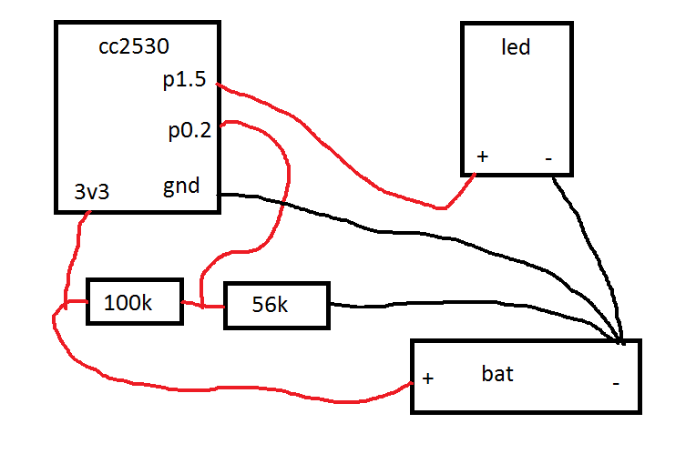

    P.S. Also below is a picture of my wiring. Is it correct?

  • The schematic looks OK but you should not put ADC sample code in hal_adc.c. You should create a periodic event in your zcl_SampleLight.c and put ADC code in periodic event to read battery voltage.

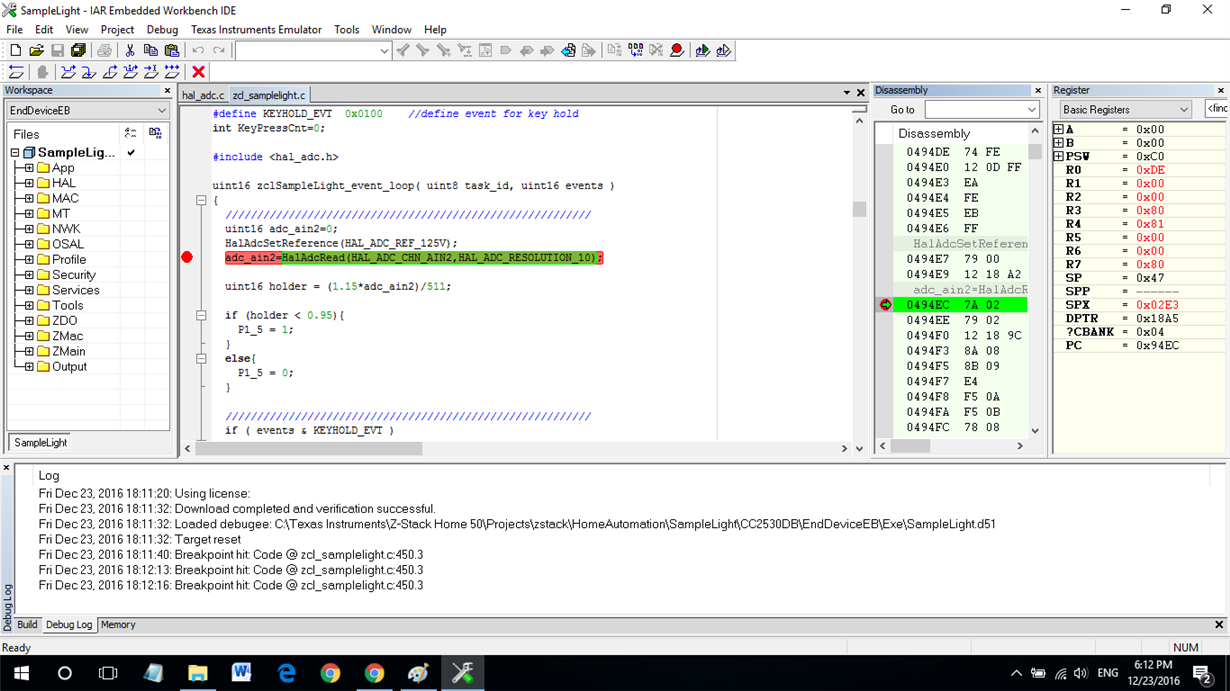

  • I will type in the periodic function later, but for now, I moved the code into the event loop:
    #include <hal_adc.h>
    uint16 zclSampleLight_event_loop( uint8 task_id, uint16 events )
     uint16 adc_ain2=0;
     HalAdcSetReference(HAL_ADC_REF_125V);
     adc_ain2=HalAdcRead(HAL_ADC_CHN_AIN2,HAL_ADC_RESOLUTION_10);
     uint16 holder = (1.15*adc_ain2)/511;
     if (holder < 1.01){
       P1_5 = 1;
    Right now the code says the LED should light up once the voltage drops below 1.01 volts, but when it does, the LED doesn't light up. How can I fix this?
  • If you change battery voltage, do you see different adc_ain2 reading in your code?
  • "do you see different adc_ain2 reading in your code"
    How do I see if the adc_ain2 is reading? Do I look at the debugger?
    Also if I change the battery voltage, the LED still doesn't light up.
  • You can set a breakpoint after ADC reading and run debug to check it.

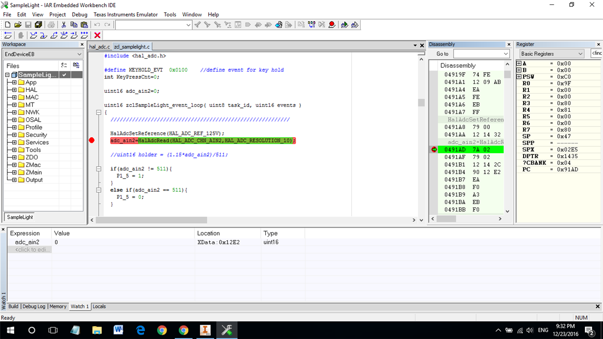

  • I can only set a breakpoint on the read line. So below is all I got.

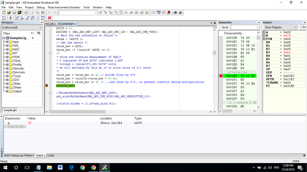

  • I changed the code to the below and the LED still doesn't light up when I give it an input of less than 1.15v. I have changed the resistors on the voltage divider multiple times for testing, but it's no good. What do you suggest?
    uint16 adc_ain2=0;
    if(adc_ain2 != 511){
    P1_5 = 1;
    else if(holder == 511){
    P1_5 = 0;
  • What do you mean no good? For example, if you change voltage divider to output 0.8V to ADC input pin, what reading do you see on adc_ain2?
  • You told me to set a breakpoint and that's what I did. I can't see any value. Is there a value I should be seeing on the debugger regarding adc_ain2? Where can I see this value?
  • You can add it to watch window to check the value.
  • When I enter the variable in the watch 1 view, I get the below message. Why can't this variable be found? (The KeyPressCnt variable above can be found)
  • Try to claim adc_ain2 as global variable and debug again.
  • It works now. However the variable always stays at 0 every time it hits the breakpoint. Why doesn't the variable change?
  • Try to use multimeter to check the voltage on P0.2 first.
  • I used a 3v battery with a voltage divider. For 1.08v, R1=100k ohm and R2=56k ohm. For 0.93v, R1=100k ohm and R2=45k ohm. I measured with a multimeter and I did get those voltages. The LED is supposed to light up when the voltage is below 1v, but it doesn't. What do you suggest?

      if( events & PERIODIC_EVT )
        //Do things that need periodic processing here!
        /* Clear ADC interrupt flag */
        ADCIF = 0;
        ADCCON3 = (HAL_ADC_REF_125V| HAL_ADC_DEC_128 | HAL_ADC_CHN_VDD3);
        /* Wait for the conversion to finish */
        while ( !ADCIF );
        /* Get the result */
        value_bat = ADCL;
        value_bat |= ((uint16) ADCH) << 8;
        * value now contains measurement of Vdd/3
        * 0 indicates 0V and 32767 indicates 1.25V
        * voltage = (value*3*1.25)/32767 volts
        * we will multiply by this by 10 to allow units of 0.1 volts
        value_bat = value_bat >> 6; // divide first by 2^6
        value_bat = (uint16)(value_bat * 37.5);
        value_bat = value_bat >> 9; // ...and later by 2^9...to prevent overflow during multiplication
        g=value_bat;
        P0SEL &= ~BV(4);
        P0DIR |= BV(4);
        P0_4=0; //Set P1.5 to low
        //////////////////////////////IF the following code keeps on turning the LED on and off every second, that means
        //////////////////////////////the periodic event isn't working correctly
        if(i==0){           //if comes here, LED will turn on
          P0_4=1;
          i=1;
        else if(i==1){      //if comes here, LED will turn off
          P0_4=0;
          i=0;
        /*if(g<=25){
          k='b';
          P0_4=1;
        else if(g>25){
          k='g';
          P0_4=0;
        osal_start_timerEx( zclSampleLight_TaskID, PERIODIC_EVT, 100000 ); //supposed to be every 10 seconds
        return (events ^ PERIODIC_EVT);
