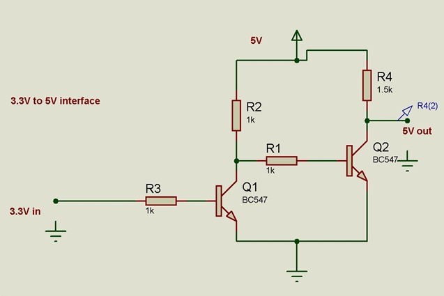

CC2530: Use LM317 to turn 3v from the CC2530 into 5v out
Part Number: CC2530
Other Parts Discussed in Thread: LM317,
What resistor values can I use for the LM317 from http://www.ti.com/lit/ds/symlink/lm317.pdf  to produce an output of 5v from an input of 3v of the CC2530? Or what equation can I use to determine the resistor values I need? The diagram of the setup should look like the below.
