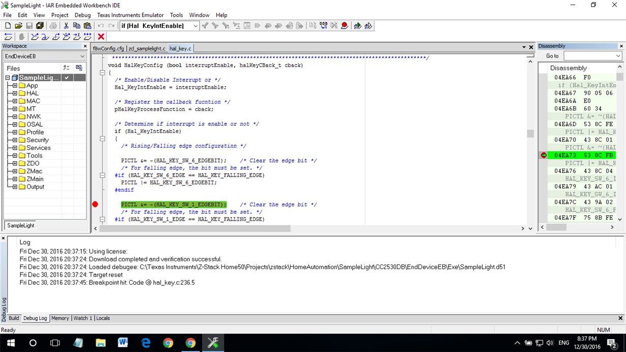

  • Do you enable keyboard interrupt in function InitBoard() in file OnBoard.c?
    /* Initialize Key stuff */
    OnboardKeyIntEnable = HAL_KEY_INTERRUPT_ENABLE;
    HalKeyConfig( OnboardKeyIntEnable, OnBoard_KeyCallback);
  • I did and it still doesn't work.

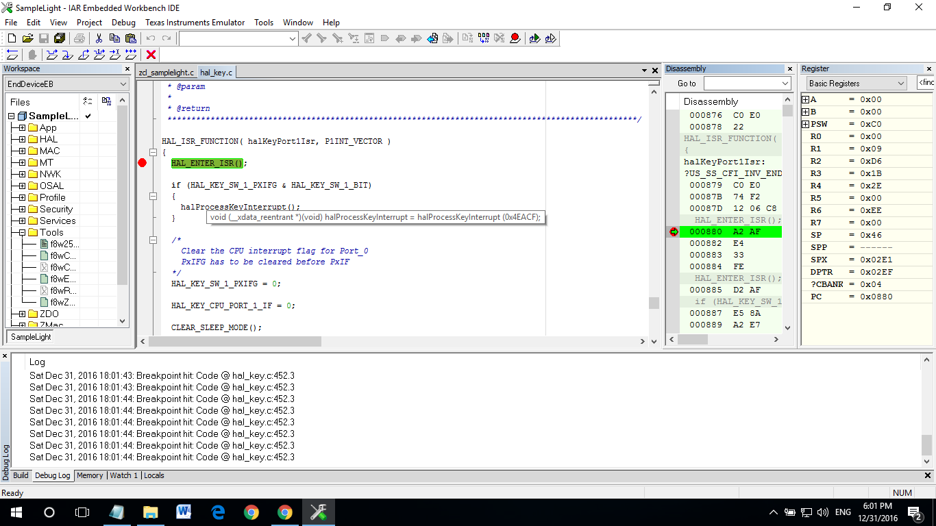

  • The edge bit of P1.7 setting is wrong. You should also revise the following line
    /* edge interrupt */
    #define HAL_KEY_SW_1_EDGEBIT BV(0)
    To
    #define HAL_KEY_SW_1_EDGEBIT BV(2)
  • I did that, but it still doesn't work. What do you suggest?
  • You change the register to SW6. You should do it to SW1, right?
  • I am not sure what you mean, but below is the port registers for P1.7 for SW1. Is it wrong? Why doesn't it work?
    #define HAL_KEY_SW_1_PORT P1
    #define HAL_KEY_SW_1_BIT BV(7)
    #define HAL_KEY_SW_1_SEL P1SEL
    #define HAL_KEY_SW_1_DIR P1DIR
    #define HAL_KEY_SW_1_EDGE HAL_KEY_FALLING_EDGE
    /* SW_1 interrupts */
    #define HAL_KEY_SW_1_IEN IEN2 /* CPU interrupt mask register */
    #define HAL_KEY_SW_1_IENBIT BV(4) /* Mask bit for all of Port_0 */
    #define HAL_KEY_SW_1_ICTL P1IEN /* Port Interrupt Control register */
    #define HAL_KEY_SW_1_ICTLBIT BV(7) /* P0IEN - P0.1 enable/disable bit */
    #define HAL_KEY_SW_1_PXIFG P1IFG /* Interrupt flag at source */

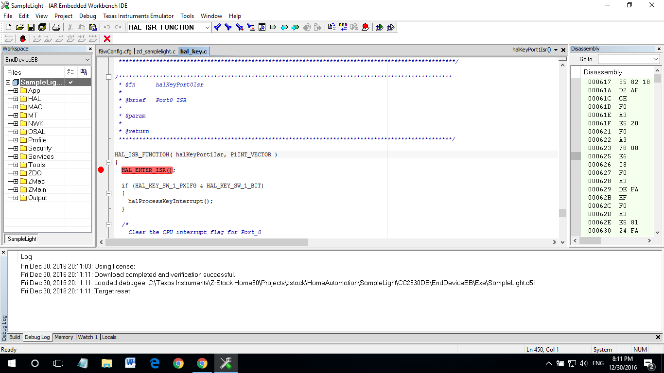

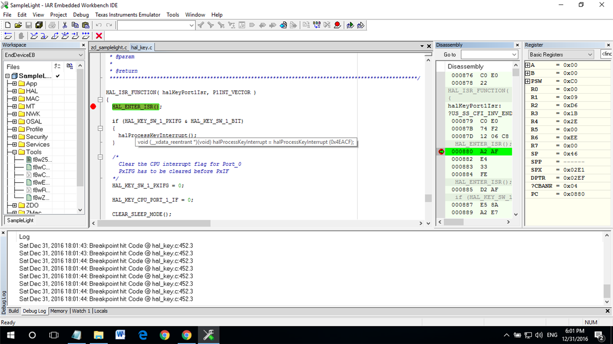

  • The configurations look fine now. Try to set a breakpoint in HAL_ISR_FUNCTION( halKeyPort1Isr, P1INT_VECTOR ) and try to trigger P1.7 to see if it hits.

  • Set a breakpoint inside "if (Hal_KeyIntEnable){...}" in function HalKeyConfig() and see if it goes into the function and configure P1.7 interrupt.
  • I set a breakpoint in there and it was hit.

  • Try to set breakpoint in
    HAL_ISR_FUNCTION( halKeyPort1Isr, P1INT_VECTOR ) and trigger SW1 to see if it hits first.
  • I set a breakpoint and it is always constantly being hit without me having to press the P1.7 button. This is strange that the breakpoint is hit, but I P1.7 isn't working. Why is this so and how can it be fixed?
  • Do you check P1IFG value to know which pin triggers ISR?
  • I am not sure how to do that. How do I check the P1IFG value to figure out which pin triggers ISR? I don't have anything, but the P1.7 connected to the CC2530. Also do you know if there may be any other problems that could relate to this issue?
  • When it hits ISR breakpoint, you can add P1IFG in debug watch window to check its value.
  • I get the value 'v' (0x76) the first time the breakpoint is hit. Then it immediately hits the breakpoint every single time and it outputs a value of'\0' (0x00).
  • 0x76 means P1. 1, P1.2, P1.4,P1.5,P1.6 trigger ISR. How do you deal with those pins?
  • I only use pin P1.2 to control the direction of a motor, but I don't use anything else. I didn't setup any of the other pins up. The only pins I need to use for the CC2530 are P0.5, P1.2, P1.3, P1.6, P1.7, P2.0. How can I disable everything else?
  • When ISR is triggered, please check what value of P1IEN is?
  • I get the value of '€' (0x80) everytime the breakpoint is hit.
  • I find another bug in your code. You should revise "#define HAL_KEY_CPU_PORT_1_IF P0IF" to "#define HAL_KEY_CPU_PORT_1_IF P1IF"
  • Now the ISR is hit when I press P1.7. However in the zcl_samplelight.c, the breakpoint isn't hit. Why is this so and how can it be fixed?

    void HalKeyConfig (bool interruptEnable, halKeyCBack_t cback)
      /* Enable/Disable Interrupt or */
      Hal_KeyIntEnable = interruptEnable;
      /* Register the callback fucntion */
      pHalKeyProcessFunction = cback;
      /* Determine if interrupt is enable or not */
        /* Rising/Falling edge configuratinn */
        PICTL &= ~(HAL_KEY_SW_6_EDGEBIT);    /* Clear the edge bit */
        /* For falling edge, the bit must be set. */
      #if (HAL_KEY_SW_6_EDGE == HAL_KEY_FALLING_EDGE)
        PICTL |= HAL_KEY_SW_6_EDGEBIT;
      #endif
        PICTL &= ~(HAL_KEY_SW_1_EDGEBIT);    /* Clear the edge bit */
      #if (HAL_KEY_SW_1_EDGE == HAL_KEY_FALLING_EDGE)
        PICTL |= HAL_KEY_SW_1_EDGEBIT;
      #endif
      HAL_ENTER_ISR();
      if (HAL_KEY_SW_1_PXIFG & HAL_KEY_SW_1_BIT)
        halProcessKeyInterrupt();
      if (HAL_KEY_SW_2_PXIFG & HAL_KEY_SW_2_BIT)
        Clear the CPU interrupt flag for Port_0
        PxIFG has to be cleared before PxIF
      HAL_KEY_SW_1_PXIFG = 0;
      HAL_KEY_SW_2_PXIFG = 0;
      HAL_KEY_CPU_PORT_1_IF = 0;
      CLEAR_SLEEP_MODE();
      HAL_EXIT_ISR();

  • Ok. Now I've added the code for SW2. However ISR isn't hit when I press P1.6. Why is this so?
      #endif
      #endif
        PICTL &= ~(HAL_KEY_SW_2_EDGEBIT);    /* Clear the edge bit */
      #if (HAL_KEY_SW_2_EDGE == HAL_KEY_FALLING_EDGE)
        PICTL |= HAL_KEY_SW_2_EDGEBIT;
      #endif
      HAL_ENTER_ISR();
      CLEAR_SLEEP_MODE();
      HAL_EXIT_ISR();
