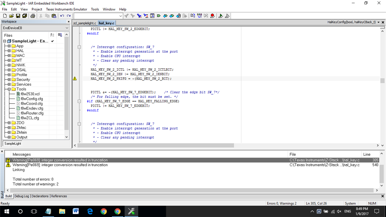

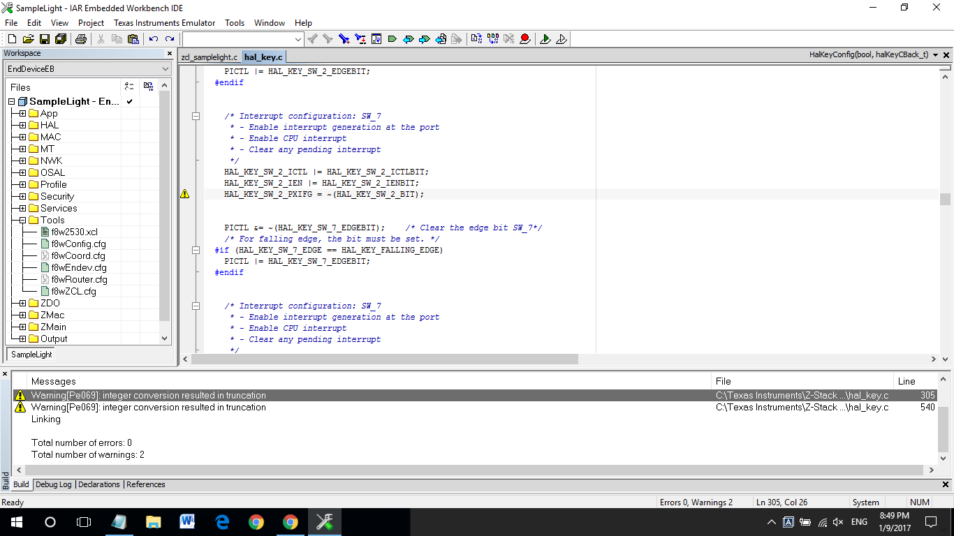

  • I keep on getting an error about the HAL_KEY_SW_2_BIT that is configured to P1.7. It says "interger conversion resulted in truncation". What is wrong with the bit and I've done some testing and found out that if I change this to any other value like 0, HAL_KEY_SW_2 doesn't do halProcessKeyInterrupt(), but however HAL_KEY_SW_6 doesn't hit the breakpoint on the below code. So there must be a direct relationship between the bit value of HAL_KEY_SW_2 and HAL_KEY_SW_6 that is causing the problem, but I don't know why this is. What do you think may be the problem? What value should the bit be?
    if ( (keys & HAL_KEY_SW_2) || (keys & HAL_KEY_SW_7) )
    forward = 0;
    backward = 0;
    DATA_PIN = 1;
