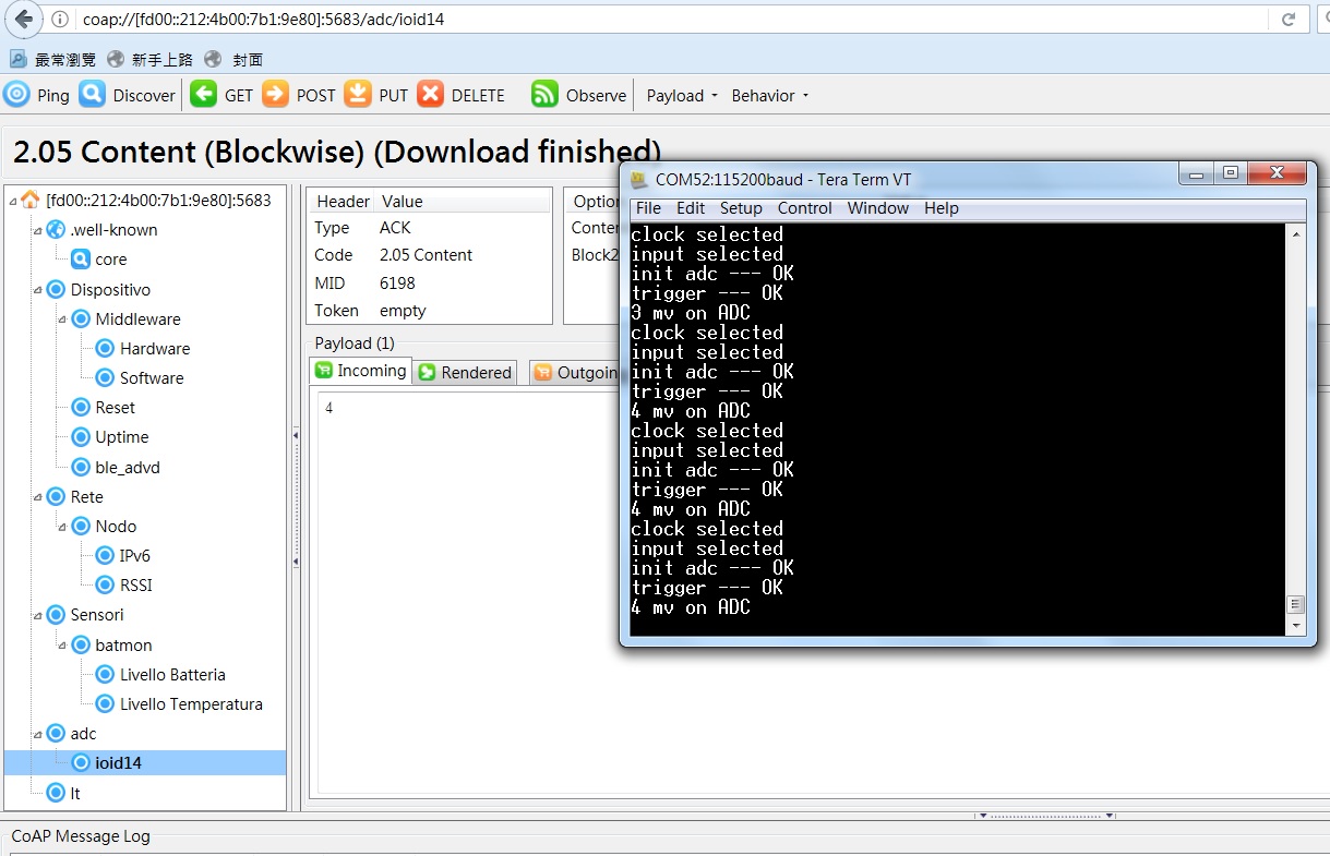

I would like to implement in the CoAP the ADC value input, can someone tell me how to move around?
  • For example, if you add a COAP resource "sen/batmon/analogic", you can to connect ADC reading with COAP resource by adding "list_add(sensor_list, &batmon_analogic_reading);" in init_sensors() (in cc26xx-web-demo.c) and adding the following code in get_batmon_reading() (in cc26xx-web-demo.c)
    if(batmon_analogic_reading.publish) {
    batmon_analogic_reading.raw = value;
    buf = batmon_analogic_reading.converted;
    memset(buf, 0, CC26XX_WEB_DEMO_CONVERTED_LEN);
    snprintf(buf, CC26XX_WEB_DEMO_CONVERTED_LEN, "%d", 78); //You can use ADC reading replace 78.
  • It comes out, but not the value of the input that I have with the sensor.
  • Do you see the reading is 78 from COAP page.
  • Yes means you see it or not?
  • Yes I see! But not the my value of ADC input
  • You have to use ADC reading to replace 78 in the code.
  • You have implemented an ADC reading process and you can use a global variable to pass the reading like "snprintf(buf, CC26XX_WEB_DEMO_CONVERTED_LEN, "%d", adc_reading);"
  • Nothing yet, I can not see my values of the ADC input. I used this guide: sunmaysky.blogspot.it/.../contiki-cc2650-adc-demo-using-dio23-as.html
  • Can you see ADC reading on UART output?
  • Yes, but i not read on CoAP
  • I don't see my value but "BlockoutOfScope".. Why?
  • I have given you step to step guide. I don't know why you cannot make it.
  • I tested the guide many times, but don't work.
  • I write the guide and the application has been running on my LAUNCHXL-CC2650 for 10 hours without any issue. I suggest you to check your code first. By the way, do you see ADC reading on UART output?
  • Can you attach your CC26xx-web-demo.c?

      if(adc_ioid14_reading.publish) {
        if(1) {
          buf = adc_ioid14_reading.converted;
          snprintf(buf, CC26XX_WEB_DEMO_CONVERTED_LEN, "%d",singleSample);
      ctimer_set(&batmon_timer, next, get_batmon_reading, NULL);

      list_add(sensor_list, &adc_ioid14_reading);

    #if CC26XX_WEB_DEMO_ADC_IOID14
      process_start(&adc_process, NULL);
    #endif

    PROCESS_THREAD(adc_process, ev, data)
      PROCESS_BEGIN();
        static struct etimer et_adc;
        while(1)
    	etimer_set(&et_adc,CLOCK_SECOND*5);
    	PROCESS_WAIT_EVENT();
            if(etimer_expired(&et_adc)) {
            //intialisation of ADC
            ti_lib_aon_wuc_aux_wakeup_event(AONWUC_AUX_WAKEUP);
            while(!(ti_lib_aon_wuc_power_status_get() & AONWUC_AUX_POWER_ON))
            // Enable clock for ADC digital and analog interface (not currently enabled in driver)
            // Enable clocks
            ti_lib_aux_wuc_clock_enable(AUX_WUC_ADI_CLOCK | AUX_WUC_ANAIF_CLOCK | AUX_WUC_SMPH_CLOCK);
            while(ti_lib_aux_wuc_clock_status(AUX_WUC_ADI_CLOCK | AUX_WUC_ANAIF_CLOCK | AUX_WUC_SMPH_CLOCK) != AUX_WUC_CLOCK_READY)
            printf("clock selected\r\n");
            // Connect AUX IO0 (IOID14, but also DP2 on XDS110) as analog input.
            AUXADCSelectInput(ADC_COMPB_IN_AUXIO0);
            printf("input selected\r\n");
            // Set up ADC range
            // AUXADC_REF_FIXED = nominally 4.3 V
            AUXADCEnableSync(AUXADC_REF_FIXED,  AUXADC_SAMPLE_TIME_2P7_US, AUXADC_TRIGGER_MANUAL);
            printf("init adc --- OK\r\n");
            //Trigger ADC converting
            AUXADCGenManualTrigger();
            printf("trigger --- OK\r\n");
            //reading adc value
            singleSample = AUXADCReadFifo();
            printf("%d mv on ADC\r\n",singleSample);
            //shut the adc down
            AUXADCDisable();
            //printf("disable --- OK\r\n");
            get_batmon_reading(NULL);
            etimer_reset(&et_adc);
      PROCESS_END();
  • Can you also attach your cc26xx-web-demo.h, coap-server.c, and res-sensors.c?

  • I test your code and it works. Try to do discover on your COAP page and test agin.
  • You have changed something?
  • I only comment out the following lines in start_board_resources() because I don't have them.
    //rest_activate_resource(&res_toggle_verde, "Led/Verde");
    //rest_activate_resource(&res_toggle_rosso, "Led/Rosso");
    //rest_activate_resource(&res_toggle_giallo, "Led/Giallo");
    //rest_activate_resource(&res_toggle_arancio, "Led/Arancio");
  • You have a board.h different from mine, then I think you have also changed that for the ioid 14. Right?
  • No, I just replace the 4 file you attached and rebuild cc26xx-web-demo. I don't think this is related to board file.
  • Exits BlockOutofScope also on temperature and battery level
  • Both work on my cc26xx-web-demo. Do you try to do Discover again? Also try to clear cache of your browser to test again.
  • I tried to reload the Discover and i also clean the cache. But always the same error.
  • No idea why you cannot make it.
  • Perhaps because I have version 1.4 of 6lbr? Or have I changed something in the coap?
  • I don't think this is related to version of 6lbr. However, you can try to checkout latest 6lbr to test again. You can git diff to check what you have changed in your code and see if there is any clue related to your issue.
  • I loaded a CC26xx-web-demo.bin old without any modification. I always Blockoutofscope on temp and battery level
  • Maybe try to git a fresh new Contiki source code and only change board file to test again.
  • It work!!!! It was a problem with internet.
  • It's good to know it works now.
  • Hello friend, today I am by implementing the value digital input in CoAP. I followed the guide that thou hast done and I just have to grow the variable that tells me if the LED is on/off. Can you help me?
  • I couldn't understand what you mean to grow the variable that tells me if the LED is on/off.

    This is a file with the implementation of the digital input on the coap, but in coap does not leave the variable that tells me that the LED is turned on or off. Can you help me?
  • Do you understand?
  • Yes. But I have show you how to setup COAP response from ADC reading, I think you should be able to LED status reading by yourself.
  • I can see on CoAP the digital asset, but I can not enter the value on/off in the CoAP. I'm trying but I can't; I am new to this work!

    Can you give us a look?
  • When you press button, do you see LED toggled?
  • You but I do not see 1/0 on CoAP.
  • I couldn't understand what you mean.
  • On CoAP I would like to have the function access/off when I press the button and the LED lights.
  • Do you create a COAP resource for this?
