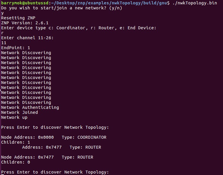

  • Dear Jason,
    I used the hex file named cc2538-znp-120-usb-tclk.hex inside \znp-host-framework-znp-host-framework\bin of the git repo: https://git.ti.com/znp-host-framework/znp-host-framework  with CC2538EM.
    I used it as a router. I got another ZigBee module CC2530 using the program (not ZNP) based on the ZigBee Z-Stack and worked as Coordinator.
    Result: That CC2538EM can join to the network with that CC2530.
    Then, I debugged and downloaded the project located at \Z-Stack 3.0.0\Projects\zstack\ZNP\CC2538\  into the same CC2538EM module.
    I repeated the above procedures.
    Result: The CC2538EM **CANNOT** join to the network with that CC2530. Here is the error:
    I assume there should be some differences between the hex file provided and the source code provided. I would appreciate that if you would find out the difference or you can provide the source code of the cc2538-znp-120-usb-tclk.hex. Thank you very much.
    P.S. I used the ZAP program provided from https://git.ti.com/znp-host-framework/znp-host-framework  and run at Ubuntu 16.04.
    Barry
  • If I remember correctly, znp-host-framework doesn't run any Zigbee profile and doesn't use TC Link key join. If you use Z-Stack 3.0 ZNP, it uses TC Link Key join and this might be the problem. Does your CC2530 coordinator runs Zigbee HA profile or other specific profile?
  • Dear YK,
    I have removed the preprocessor “TC_LINKKEY_JOIN” in IAR setting. The problem still exists.
    P.S. I used Zigbee HA profile, the example called "SampleLight" in my cc2530 module.
    P.S.2.
    There is noting to do with the CC2530 module. Because, for the normal hex file image (cc2538-znp-120-usb-tclk.hex), the CC2538 keeps popping the word "Network Discovering" in the console even there is no coordinator.
    For the source program I used ( \Z-Stack 3.0.0\Projects\zstack\ZNP\CC2538), the console only pops up "Network Discovering" two times and then "Network Error" is indicated.
    Barry
  • As I replied you in previous post, znp-host-framework doesn't use any Zigbee profile but SampleLight does. This is why your device cannot join CC2530 SampleLight.
  • Dear YK,
    I don't familiar with the mechanism of Zigbee profile. In this case, the Zigbee profile should be in (i) ZNP program or (ii) ZAP program? or I need to modify both of them?
    Barry
  • I would say both. If you intend to join SampleLight which is based on Zibgee HA profile, I would suggest you to use CC2538ZNP-UART-Pro-Secure_LinkKeyJoin.hex (under C:\Texas Instruments\Z-Stack Home 1.2.2a.44539\Projects\zstack\ZAP\ZNP-HexFiles\CC2538 if you install Z-Stack Home 1.2.2a) and ZTool to act as ZAP to join your CC2530 SampleLight coordinator.
