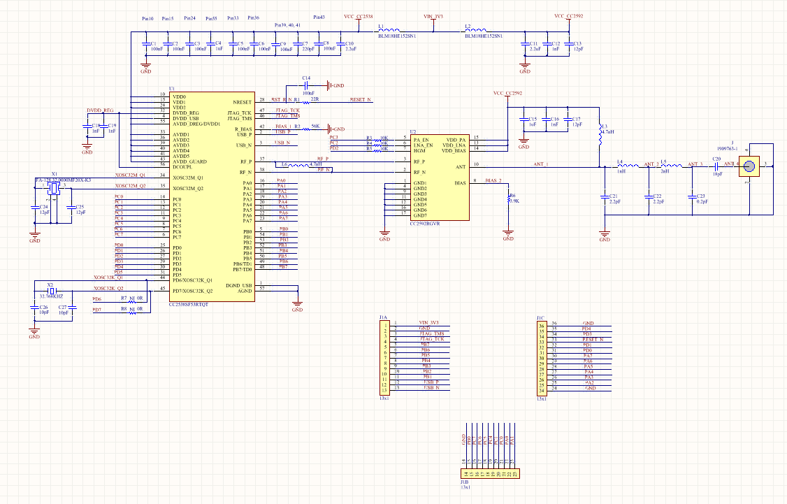

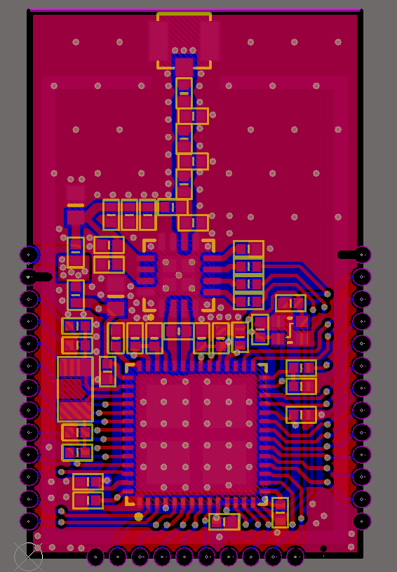

Hi all,
I have designed CC2538 + CC2592 module. The schematic is below:
I need everyone help to review the 2-layers layout.

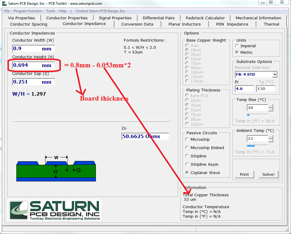

This layout is designed on FR-4 PCB, 0.8mm board thickness, 53um copper thickness. I use the Saturn PCB tool to calculate the impedance of antenna trace below:

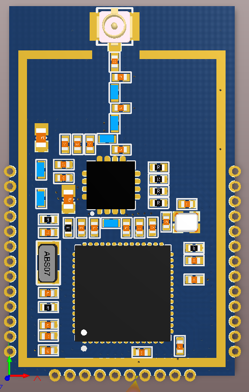

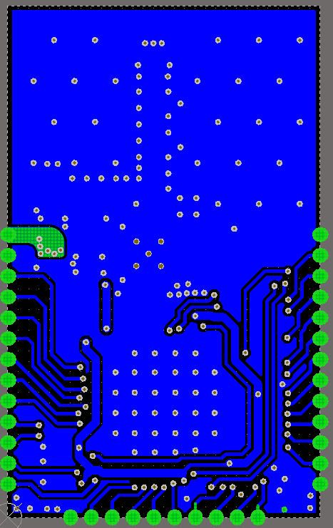

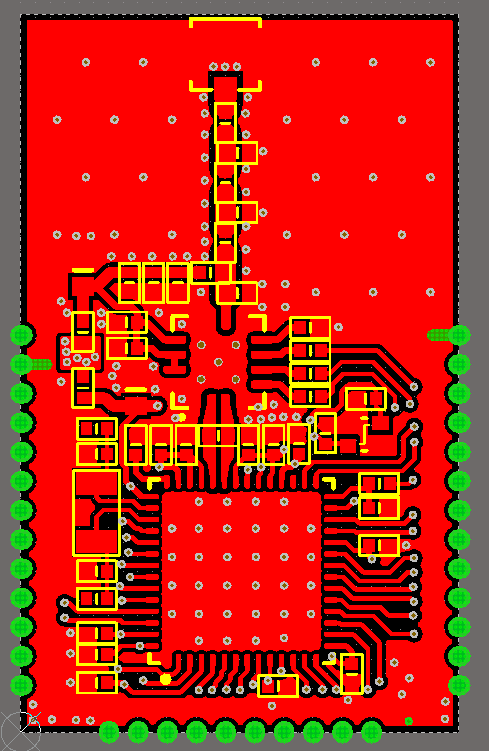

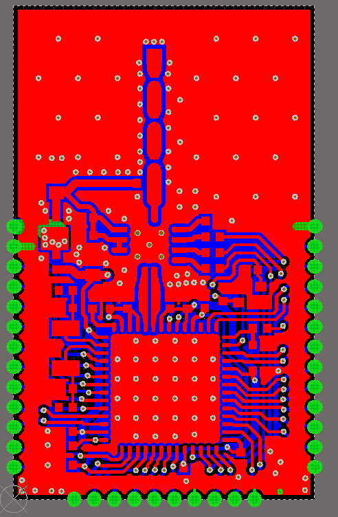

And these are the TOP, BOTTOM and 3D layer. Can everyone take the time help to review. Thank all so much.
TOP:
BOTTOM
TOP + BOTTOM
3D
    It looks Good except the following minor issues.
    C18 & C19 must be 1uF.
    C8 must be placed near Pin-43 ( you may move the crystal a little far to make the room for C8).
    Pins 13, 14 & 15 on CC2592 can be shorted together (Please see Ref design - SWRC286 ) and use One single trace to feed them
    PM
  • Hi TI supporter,
    I have fixed these issues which is recommended by you.
    The Gerber has already sent to FAB. I will report the performance to you later.
    Thank you so much.
