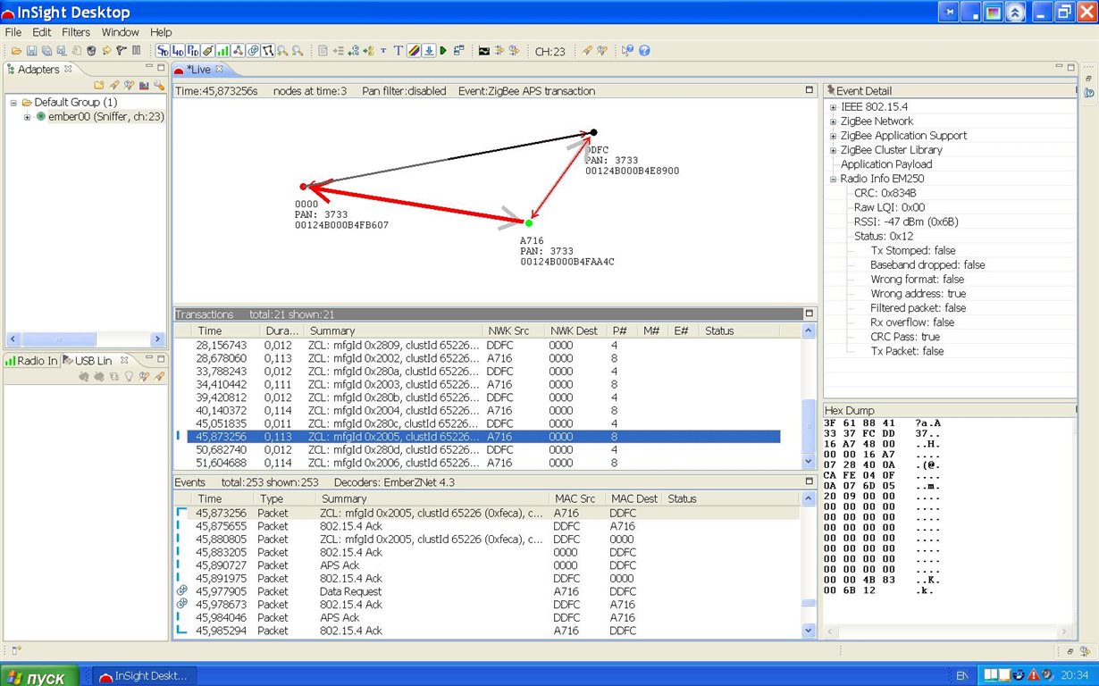

I have Zegbee Network. It is to routers (ZR), ZC, and same ZED.

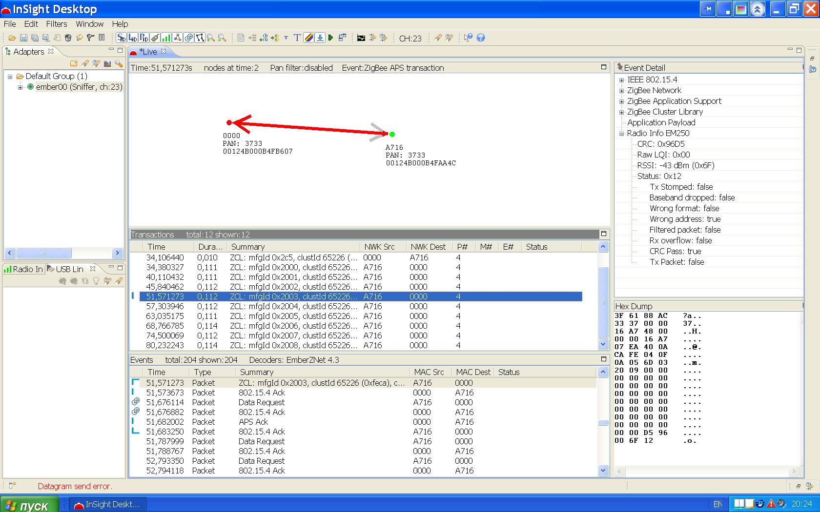

Whan power on my system i can see all messeges from ZED to ZC, Than I power off ZC. After power on ZC the ZED don't get APSAcknoleg (err code 0xb7). But the ZC get messege from ZED. (I controll this by LED, debugger and Sniffer) If i send messsge from ZC to ZED this massege correct go to ZED. If i send messege from ZED to ZC the no acknoleg.
If I power off ALL ZR the ZEDs start to send messege correct.
In this experement I'm use CC2530-CC2592EM-RD with ZNP - firmware connection to my host uC.
The version of software is Z-Stack Home 1.2.2a.44539.
The compile options by default.
The change only two option. They are uncommented. (By default they are cmmented)
-DSRC_RTG_EXPIRY_TIME=255
//-DMAX_RTG_SRC_ENTRIES=100
