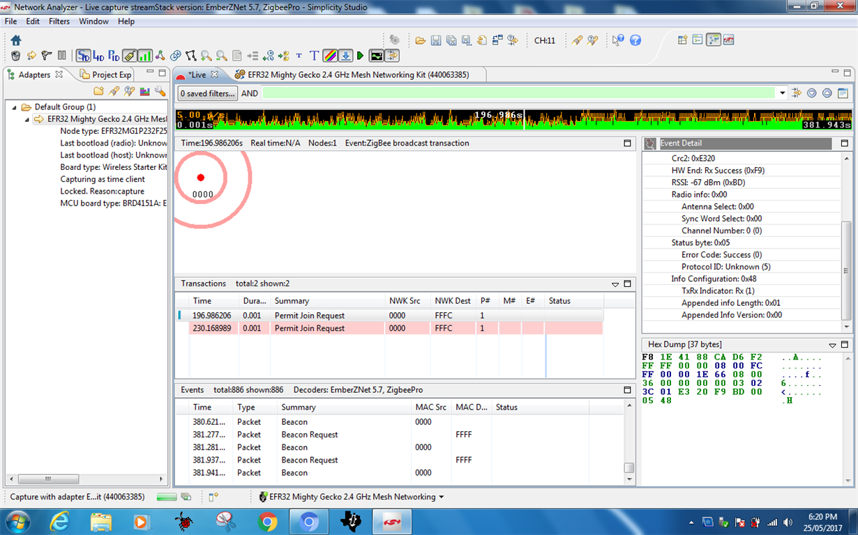

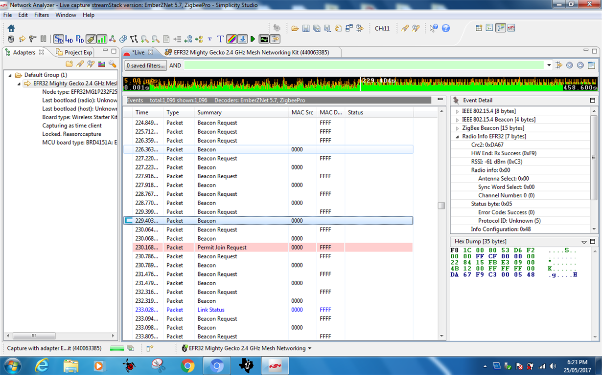

  • Hi Yikai ,
    I captured packets using Mighty gecko as the sniffer and attached below are screenshots of packets. From the logs I think the coordinator is up and working fine but enddevice is not properly configured and responding. What can be the possible issue?

  • I think you should focus on why your device doesn't send beacon requests to join coordinator.
  • Hi Yikai,
        From the screenshots we can see that enddevice is sending beacon requests and also the coordinator is sending beacon....Please correct me if am wrong..

  • Anyway, I open it with my Simplicity Studio. I think your device had joined other Zigbee network so it won't join current one. I suggest you to do a factory reset to clear network information on your device and try to join it to the coordinator again.

  • If the device is associated to a coordinator, you can check the connection from sniffer. Since your end device is sending beacon requests and not associated to any coordinator, it won't listed on simplicity studio. Since you have disabled NV_RESTORE, endevice shouldn't get connected back to the previous coordinator after power recycle.
  • Hi Yikai,
    Upto my understanding I think the enddevice sends beacon requests as soon as it is powered up and is ready to join, and the coordinator sends Beacon on receiving a beacon request from enddevice. From the sniffer logs it is seen that both are happening and neither my enddevice is associated with any other coordinator then why the device is not getting joined to coordinator on giving permit join from TI Demo app running in coordinator? Anything missing from configuration?
  • I think the problem is on end device and suggest you to set a breakpoint in ZDO_NetworkDiscoveryConfirmCB to check what happens.

    Is there anything else I need to take care from ZNP / Enddevice image side?
    Also do we need SPI related changes in enddevice stack?
