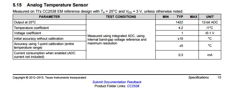

Found that the temperature sensor in CC2538 was inaccurate.
I believe this inaccuracy is influence by certain parameter but I wasn’t sure what could have influence it.
In our configuration, the ADC is using internal reference and we did a calibration at a fixed temperature by adding the different back from the value we capture from ADC.
The hardware consist of top PCB which contain the CC2538 and the bottom PCB which will be the IO and power supply (battery).
So the calibration for the top PCB was done with the bottom PCB connected to my bugger with a fixed voltage of 3.3V.
The same bottom PCB will be used for all the top PCB for calibration.
However, when the top PCB were attached to other bottom PCB after the calibration, it will still give out an inaccurate temperature value.
So what could have affect the CC2538 giving inaccurate temperature value?
Could it be due to different voltage where the bottom PCB was power by battery (around 2.6V) and calibration was done on 3.3V?
However, since we are using internal reference, I believe the supply voltage shouldn’t have any effect.

    You did not disclose any values about what you have measured, here is what the datasheet says about the accuracy of the CC2538 temperature sensor. How does it compare.
    /TA
  • Hi TA,
    The things I observed is that when the same device was put back in bottom PCB which is use for calibration, it gives more accurate result.
    Anyway, with 1 point calibration, there is device that giving temperature of 22 deg C when the room temperature is about 28 deg C.
    This is only happen after I put it on the different bottom PCB than the one use to calibrate.
