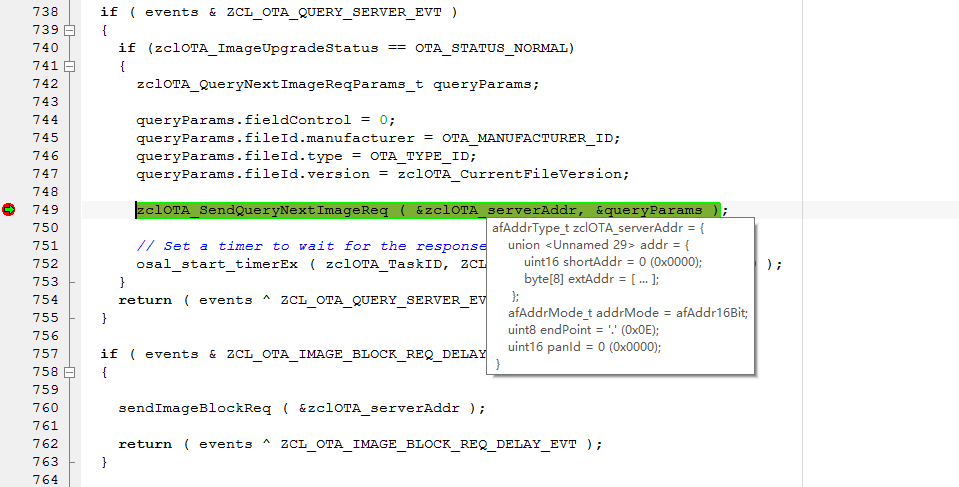

I added OTA server feature upon ZNP project,but zclOTA_HdlIncoming callback function can't be call on OTA server side. Z-Stack 3.0 ZNP project.
zcl_registerPlugin ( ZCL_CLUSTER_ID_OTA,ZCL_CLUSTER_ID_OTA,zclOTA_HdlIncoming );
This is my following steps:
1. add zclOTA_Init( taskID++ ); at last of osalInitTasks() func;
2. add zclOTA_event_loop events callback at last tasksArr arrary;
3. add Preprocessor MT_OTA_FUNC OTA_SERVER=TRUE OTA_HA in ZNP project options per line;
                       ZCL_CLUSTER_ID_OTA,

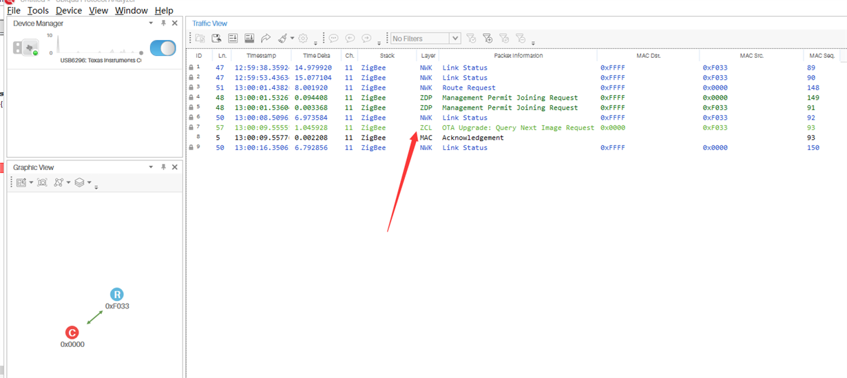

4. But zclOTA_HdlIncoming callback function can't be call when other OTA client sent a "Query Next Image Request" to ZNP(coordinator mode),what's wrong with me?following image is Ubiqua sniffer capture log:
5. The following image is IAR workbench step through when OTA client(0xF033) sent image request to ZNP(0x0000):
6. I review all Z-Stack 3.0 project source code,I have found ZCL_STANDALONE don't defined by default,I don't know what's meaning. Very very important is zcl_Init( taskID++ ); and zcl_event_loop is not be call in all ZNP project,this caused zcl task can't be create,this may be caused  zcl_TaskID task can't receive any AF message?

    Fortunately,we have found that bugs in znp.eww project,and fix that.
    Steps:
    1. Modify the following source code in znpEventLoop function(znp_app.c source file)
          case AF_INCOMING_MSG_CMD:
    #if defined ZCL_KEY_ESTABLISH
            if (ZCL_KE_ENDPOINT == (((afIncomingMSGPacket_t *)pMsg)->endPoint))
              zcl_ProcessMessageMSG((afIncomingMSGPacket_t *)pMsg);
            else
    #endif
              //comment following line,add zcl_ProcessMessageMSG function call
              //MT_AfIncomingMsg((afIncomingMSGPacket_t *)pMsg);
            break;
    2. Rebuilt znp.eww project,zclOTA_HdlIncoming callback function must be work correctly.

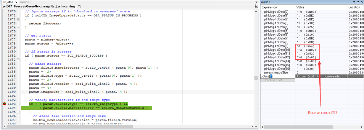

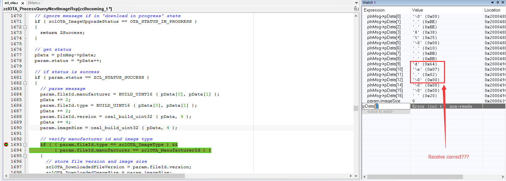

  • Currently,I have encounter a bugs.
    1. On OTA upgrade Image Request Stage,OTA server will sent "Image Response" to OTA client with imageSize to tell the client there image size,but client receive incorrect.
    2. The following Image present left side is Ubiqua sniffer capture"Query Next Image Response",imageSize is 132964(0x20764),I'm guarantee sent side must be correct,right side is step through on client side in zclOTA_ProcessQueryNextImageRsp function(IAR workbench IDE),but the receive side received imageSize is zero,what's wrong with me? This may be a IAR workbench build tool chain bugs?
    3. The following image present the memory contents on client side.The red mark on the right side is memory contents of 4 bytes imageSize(part of structure zclOTA_QueryImageRspParams_t),as we see,the receive content seem correct,and osal_build_uint32 return seem no error,but imageSize is zero,this is very very strange.
  • Hi Hold Li,
    That is pretty strange...
    Have you manage to solve it?
  • I have solve that bugs(this may be caused by IAR for ARM tool chain),I reboot the computer and reopen IAR for ARM,all well.
