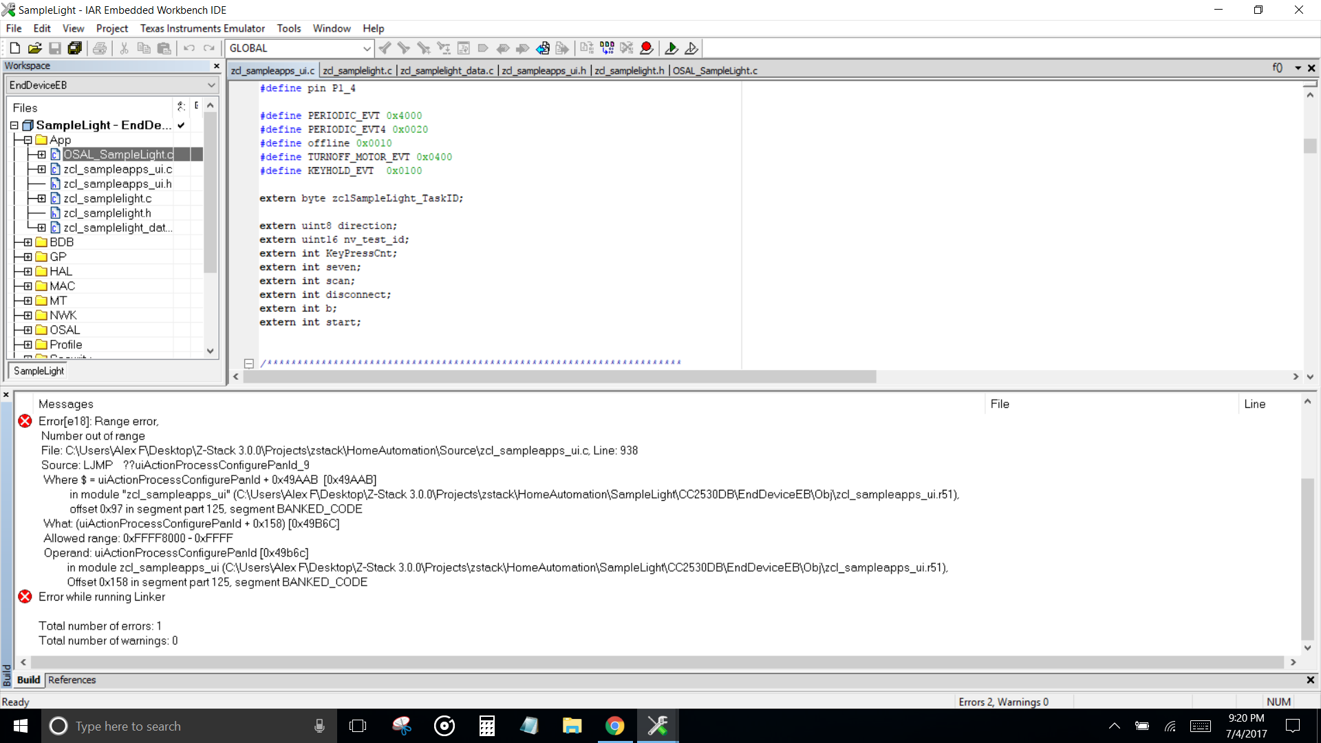

Hi, I wanted to know how I could convert my old samplelight.c file into the new Z-stack 3.0 samplelight. What major changes would I have to do to get my code working with the Z-stack 3.0 samplelight? I've been trying, but am struggling, and I would appreciate any help towards my cause.

  • For the application part, it's similar. You can merge your code into zcl_samplelight.c and also need to revise the hal_key.c/.h.
  • So now I've revised the hal_key.c. Below are my code revisions so far in Z-stack 3.0. However it keeps on giving me a linking error. Am I doing this wrong?

  • What link error do you see?
  • I get the below error.
  • If you use KeyPressCnt in OSAL_SampleLight.c, you should extern KeyPressCnt in your OSAL_SampleLight.c.
  • I am confused. How exactly do I do that?
  • Where and how do you claim KeyPressCnt?
  • In zcl_samplelight.h as an integer value.
  • Can you attach your OSAL_SampleLight.c?
  • Here it is.

  • I think you have to move "int KeyPressCnt=0;" from zcl_SampleLight.h to zcl_SampleLight.c and add "extern int KeyPressCnt;" in your zcl_sampleapps_ui.c
  • So I moved everything from zcl_samplelight.h back to zcl_samplelight.c. Then I used extern for everything in zcl_sampleapps_ui.c. However I get the below error on the image. How can I fix this?
    zcl_sampleapps_ui.txt
  • You cannot use Onboard_wait on line 938 of zcl_sampleapps_ui. It would block other task.

    1. How can I get the the uiActionResetToFactoryNew() function to work as shown in the image below?
    2. How can I get the the UI_DeviceStateUpdated() function to work as shown in the image below?
  • 1. You should change "static void uiActionResetToFactoryNew(uint16 keys);" to "void uiActionResetToFactoryNew(uint16 keys);" in zcl_sampleapps_ui.c and add "extern void uiActionResetToFactoryNew(uint16 keys);" in zcl_sampleLight.c to use it.
    2. You have to add "extern void UI_DeviceStateUpdated(devStates_t NwkState);" in zcl_sampleLight.c to use it.
    These are very fundamental of C programming and I suggest you to enhance your programming skill.
  • Thanks. This helps a lot.
  • You are welcome.
