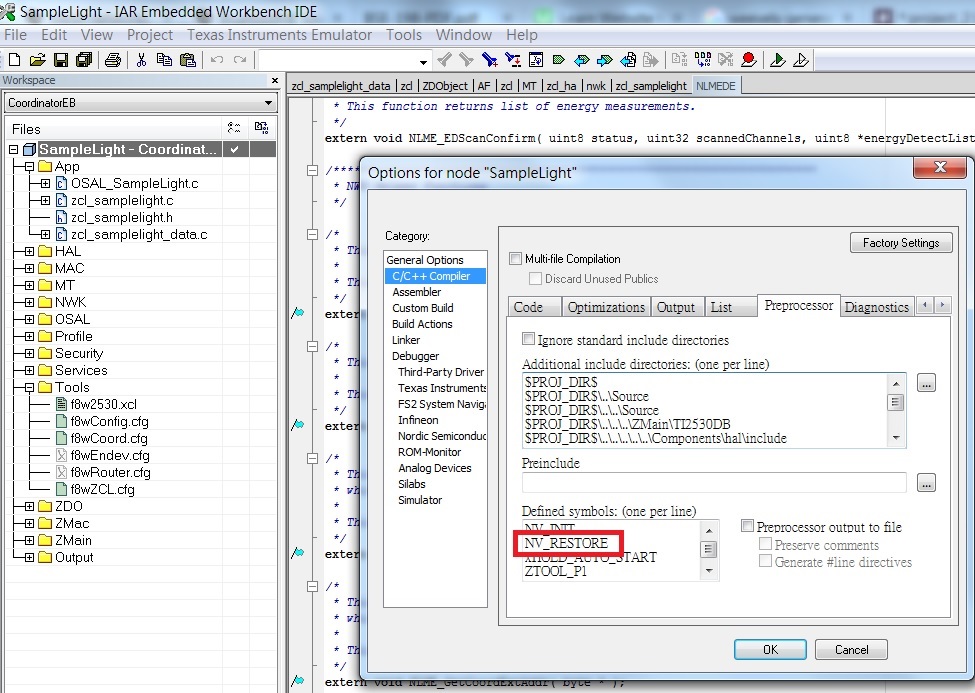

    I enable the "NV_RESTORE " in "nwk_globals.h" like,
    #define NV_RESTORE TRUE
  • If you intend to get the IEEE address of itself, you can use API NLME_GetExtAddr to get it.
  • To enable NV_RESTORE, you should add it in Project->Options-> C/C++ Compiler->Preprocessor->Defined symbols.
