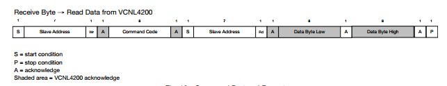

    I am trying to read data from my VCNL 4200, the read format is like
    So, I have to send the command: "0x08H_L", how to send commands in I2C.
    Please review my code too, I am using VCNL4200 demo board it has configure Pullup in board.

  • Sorry for disturb, To read I has to send " PS_Data"
    08H_L PS_Data_L
    08H_H PS_Data_H
    So, I think it's need to send 08H_L to read lower byte of sensor data and 08H_H for higher byte of sensor data, finally it's a 16 bit data. And it may be 0x08 and 0x08 has to send. is my understand is write.
  • According to my understanding to the datasheet, it should be send command 0x08 and you can read two continuous bytes which is PSPDATA_L and PS_DATA_H.

    Thanks for check of Datasheet.
    My slave is not giving this action I2C_SLAVE_ACT_TREQ,
    I mean below loop is not completing, after sent read request to Slave.
    while(!(I2CSlaveStatus() & I2C_SLAVE_ACT_TREQ))
    Thank you.

  • Hi Chen,
    Can you please look at here, Our sensor is trying to send the 16bit data, but I2C master is receiving only one byte. How can I read the number of bytes.
    uint32_t I2CMasterDataGet(void)
    // Read a byte.
    return(HWREG(I2CM_DR));
  • Call I2CMasterDataGet() to get first byte and call I2CMasterDataGet() again would read the seconds byte.
