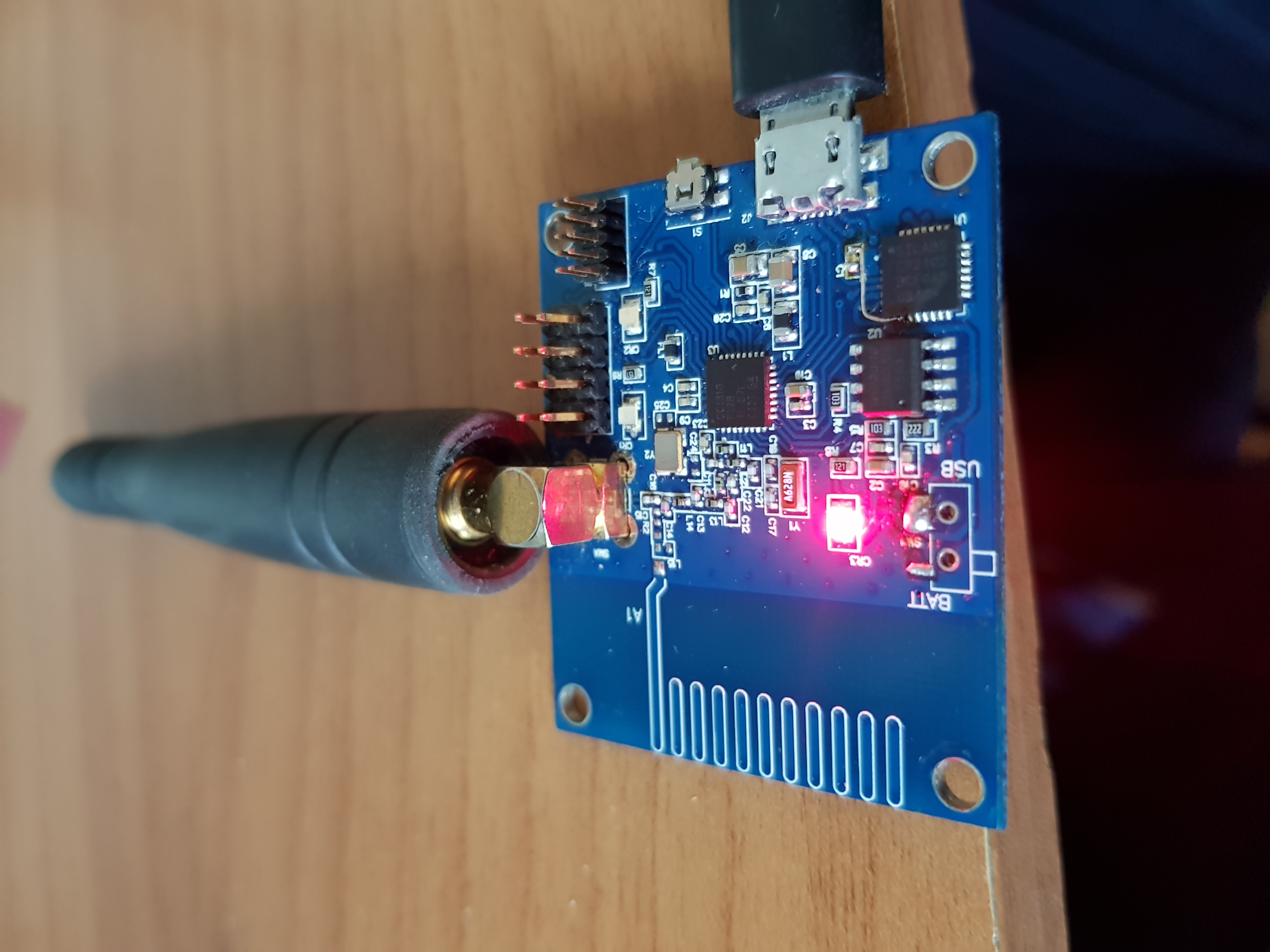

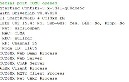

Hi, I use Slip-Radio and CC26xx-web-demo. On the server 6lbr I can open the CoAP but not "web" for read the value of MQTT. Why?

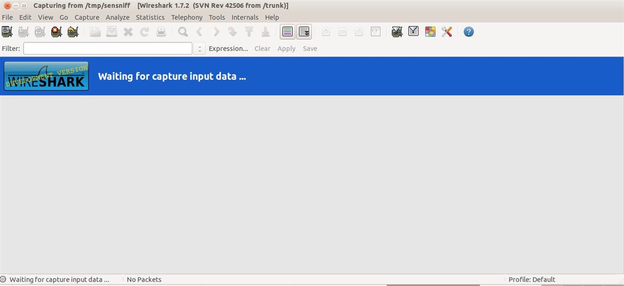

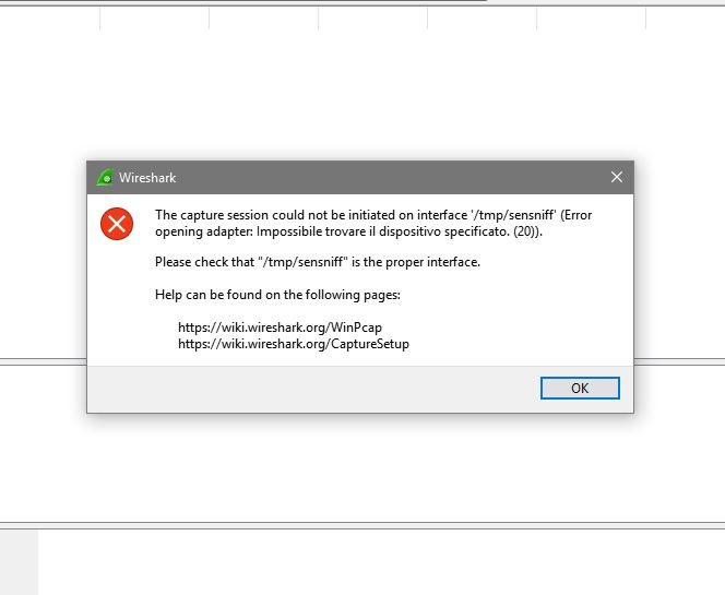

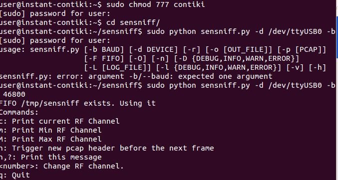

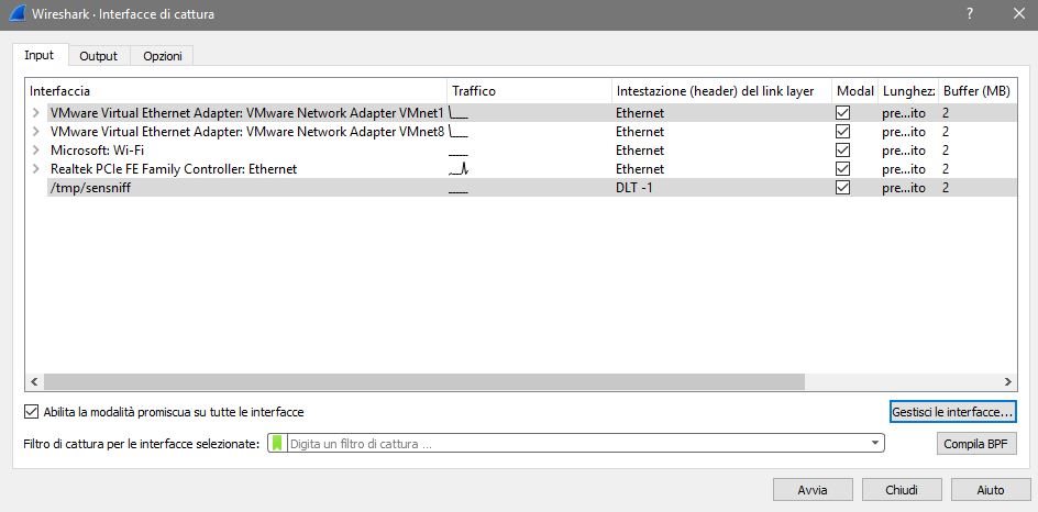

Yes, I followed the steps you sent me. When connecting the CC1310 to the rasp and typing the sensniff steps, it is created perfectly. But with Wireshark I have problems!
I can only suggest you to printf some information in mqtt-client.c to check if your application keeps running.
