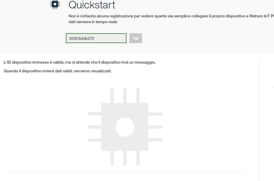

Hi, I use Slip-Radio and CC26xx-web-demo. On the server 6lbr I can open the CoAP but not "web" for read the value of MQTT. Why?

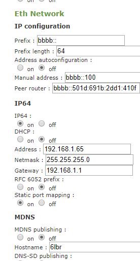

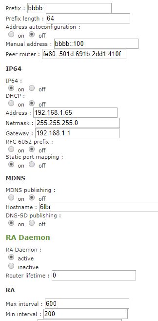

It looks the Peer Router setting is correct. If you try to run the following tcpdump command on 6lbr, do you see anything is sent out on port 1883
tcpdump –X –v –i eth0 port 1883
