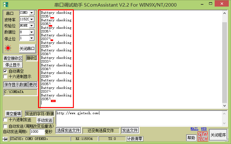

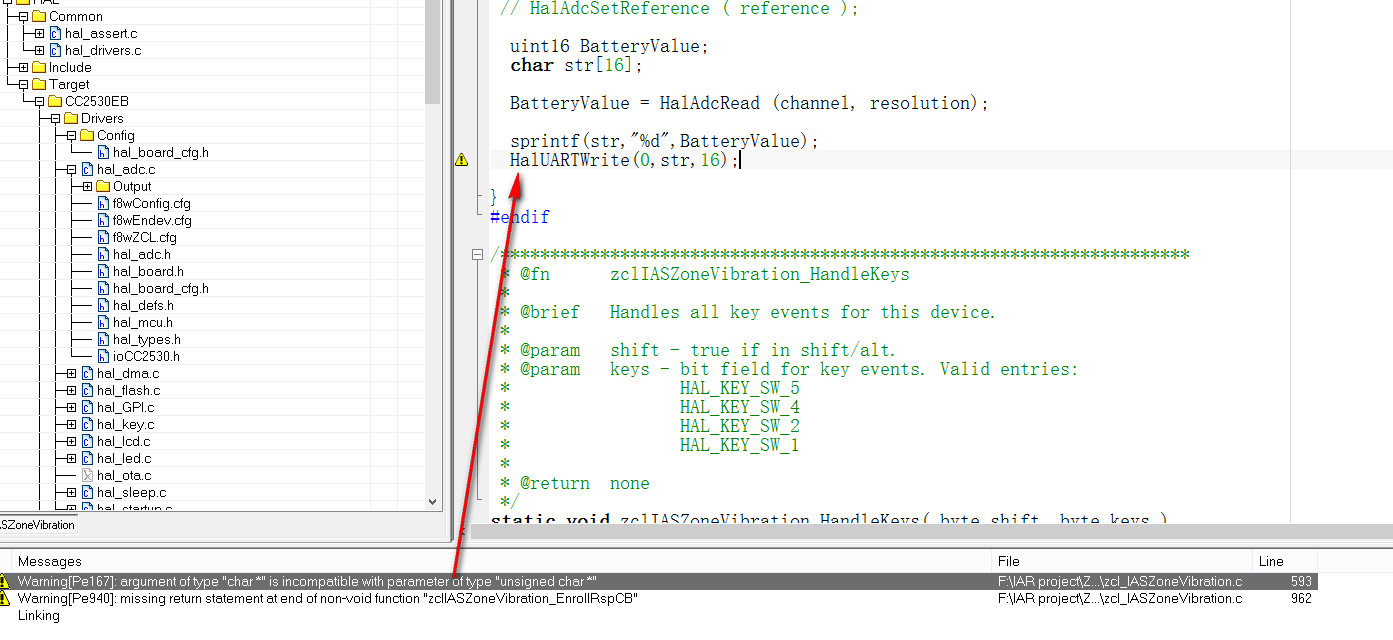

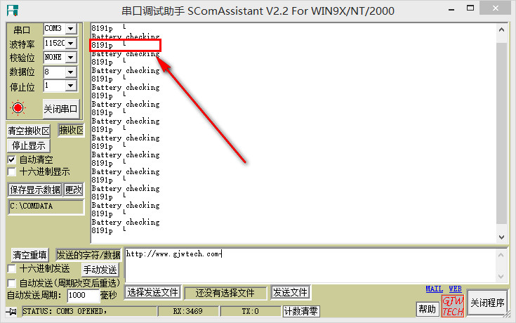

I'm now using the internal cc2530 VDD/3 to measure the voltage of battery, however, I found that I cannot get the correct value according to the adc program.
Could someone help me to see what's my problem?
I test this program both on the smartrf05eb and bb, both the readings were wrong. Thank you.

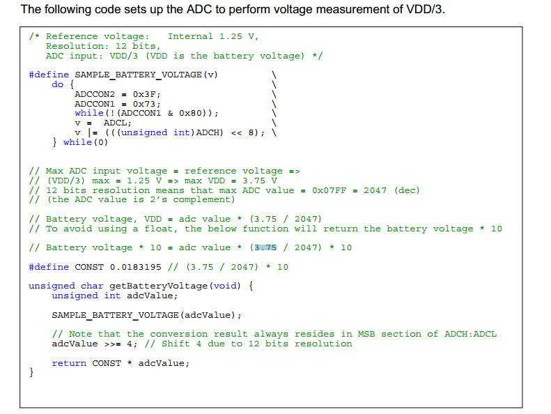

int8 HalAdcGetVdd (void)
ADCCON3 = 0x0F;
while (!(ADCCON1 & 0x80));
return ADCH;
int8 HalAdcGetTmp (void)
ADCCON3 = 0x0E;
return ADCH;
