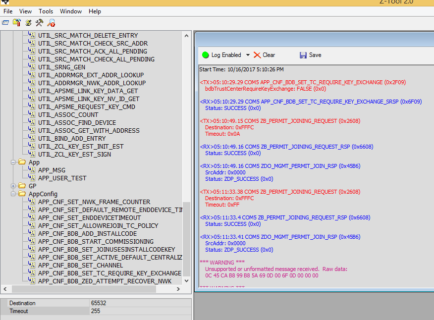

Hi ,
I have uploaded ZNP from ZStack 3.0 on CC2531 USB Dongle . I am using ZTool to send and receive commands.
I have sent ZB_Permit_joining_request command to the dongle  and I have received a response from a end device as below
ZDO_END_DEVICE_ANNCE_IND (0x45C1)
scrAddr :0x6DEB
NwkAddr:0x6DEB
IEEEAddr:0x000D6F000B102449
Capabilities:0x80
After a few seconds i am receiving a another respose of device leaving
ZDO_LEAVE_IND (0x45C9)
srcAddr:0x6DEB
extAddr:0x000D6F000B102449
request:0x00
removeChildren:0x00
rejoin:0x00
I cant understand why the device joins and automatically disjoins. I have even tried network streering and procedure from the blog sunmaysky

  • You must allow legacy devices to join your Zigbee 3.0 network, they are being rejected because of the new Zigbee 3.0 security scheme. You can allow legacy devices to join by setting BDB_DEFAULT_TC_REQUIRE_KEY_EXCHANGE to FALSE in bdb_interface.h
  • Hi Chen,
    I have tried above option by sending APP_CNF_BDB_SET_TC_REQUIRE_KEY_EXCHANGE with value Flase, but the issue is still the same.
    Karim

  • How do you send APP_CNF_BDB_SET_TC_REQUIRE_KEY_EXCHANGE with value Flase?
  •  COM5_fnal.rtfI have attached the screenshot of my ztool and log. Please see.
  • I suggest you to use Ubiqua Protocol Analyzer to check what happens over the air.
  • Thanks, but I dont have sniffer right now as I have changed the firmware from sniffer to ZNP on cc2531.

    <TX>03:42:32.23 COM5 ZDO_MGMT_LQI_REQ (0x2531)
        DstAddr: 0x0000
        StartIndex: 0x00
    <RX>03:42:32.23 COM5 ZDO_MGMT_LQI_REQ_SRSP (0x6531)
        Status: afStatus_SUCCESS (0x0)
    <RX>03:42:32.23 COM5 ZDO_MGMT_LQI_RSP (0x45B1)
        SrcAddr: 0x0000
        Status: ZDP_SUCCESS (0x0)
        NeighborTableEntries: 0x02
        StartIndex: 0x00
        NeighborLqiListCount: 0x02
        NeighborLqiList:
        ExtendedPanID: 0x00124B0001DD847F
        ExtendedAddress: 0x000D6F0004482F75
        NetworkAddress: 0x15B4
        Reserved_7_Relationship_6_4_RxOnWhenIdle_3_2_DeviceType_1_0: 0x15
        Reserved_7_2_PermitJoining_1_0: 0x02
        Depth: 0x01
        RxLQI: 0xAA
        ExtendedAddress: 0x000D6F000D695AB8
        NetworkAddress: 0x0E98
        Reserved_7_Relationship_6_4_RxOnWhenIdle_3_2_DeviceType_1_0: 0x12
        Depth: 0x01
        RxLQI: 0xAA
    Coordinator MAC add : 0x00124B0001DD847F
    End devices : 0x000D6F0004482F75, 0x000D6F000D695AB8
    Does this mean that the device has joined the network ? . I have setup the ubiqua protocol analyzer and I will share the log soon .
  • I cannot judge this from ZTool response. I need Ubiqua log to know it.
  • Zstack3.0 log.zipHI Chen,
    PFA, Ubiqua log and ztool log for ZStack 3.0 on CC2531 and NYCE motion sensor . I could see that the device is being configured for few seconds but finally could not join the network. I will soon share the log for HA 1.2 as well.
  • PFA the latset one for ZStack 3.0Zigbee.zip
  • In your sniffer log, coordinator only enable permit join for a very short time.
  • I have even tried with 255 (0xff) the result is the same, one of the above two attachments has it.
  • You can set it to 254 at most in Zigbee 3.0
