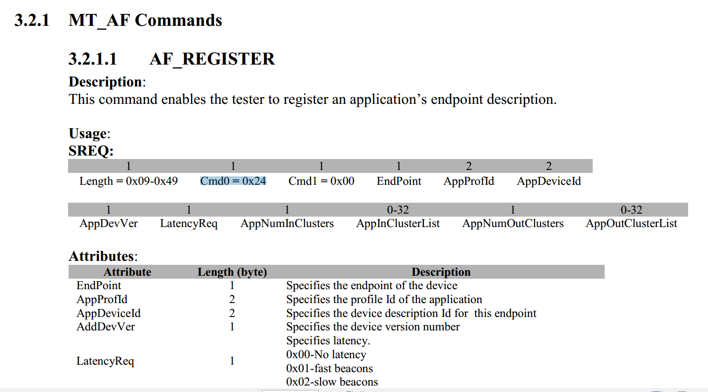

i have coordinator that it is znp
and router that it is 8051
till now i have device indication in coordinator so router is joined with coordinator and ready to send data
im using these codes to send data to coordinator and none of them work

this code below is for afregister znp coordinator
0xFE,0x09,0x24,0x00,0x01,0x01,0x00,0x01,0x00,0x01,0x00,0x00,0x00
this code below is for afregister router
afRegister(&DoorSensorEndPoint);
why data is not sended?
