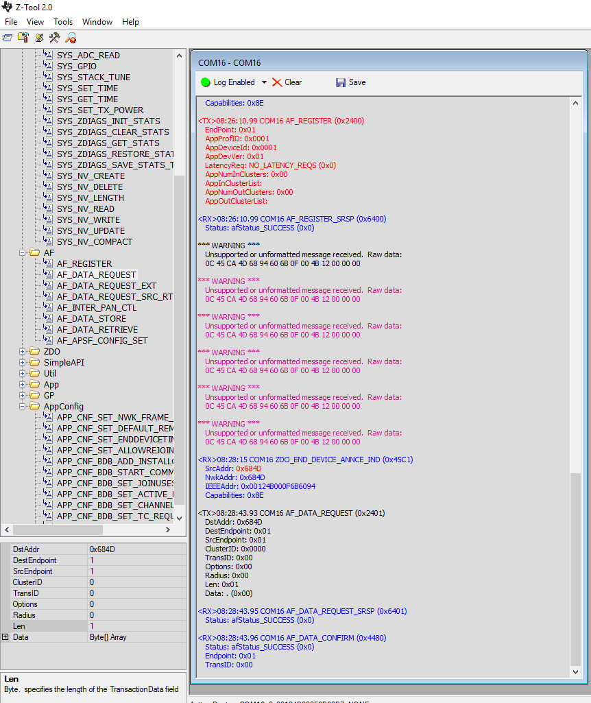

cc2530: did i send data correct?
Part Number: CC2530
Other Parts Discussed in Thread: CC2530
hi
in this pic i have znp coordinator  cc2530 that sending data to router zigbee 8051 cc2530
i have acknowledgment so it's definitely received in router right?
where in cc2530 router 8051 in iar i should make a breakpoint to see data on it?
im using sample light project as router here
  • Try to set a breakpoint in afBuildMSGIncoming() to check it router receives the message.
  • where is this function?
    i did not find it
  • It's in AF.c.
  • i did printf("arrived") in afBuildMSGIncoming()
    when it's joining its hit 3 time but when im using afdatarequest to send data to it, it's not hitting
    so the message is not receiving there. why?
  • Don't use printf to do debug. I suggest you to pause the program and set breakpoint in IAR after device joins coordinator. Then, press go to keep debugging.
  • nothing  happend
    see the c file that im editting in samplelight in attachment
    in coordinator znp cc2530 i do whatever u say in ur blog and it work for znp router fine and awsome
    but when i use sample light project no way
    please see file that is in attachment and tell me where did i go wrong
