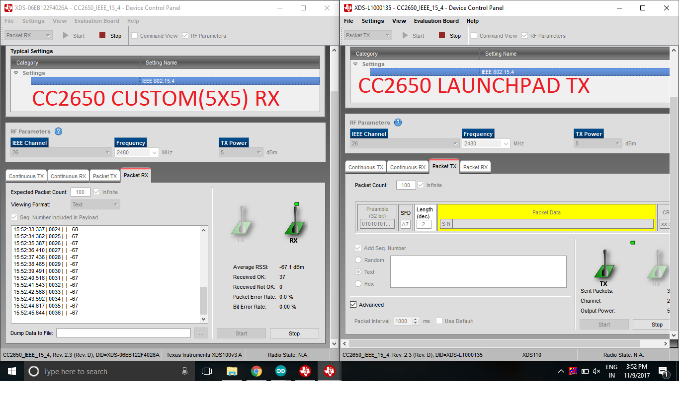

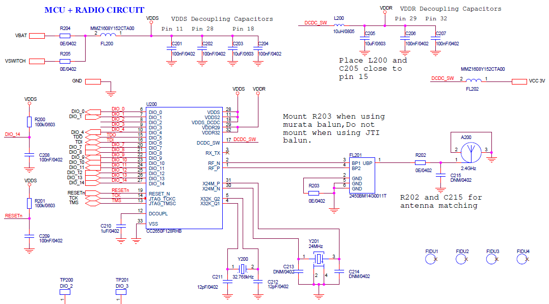

Ideally what should be the End device radio range with 5dbm Tx power and PIFN antenna with JTI Balun?
I am using cc2650 with JTI balun reference design but i think RF is not performing well, Because even if i keep the end device near to the coordinator then also it does not join or rejoin the network immediately...i can see beacon request in sniffer but devices does not sends association request or rejoin request quickly ..like ti cc2650emk
