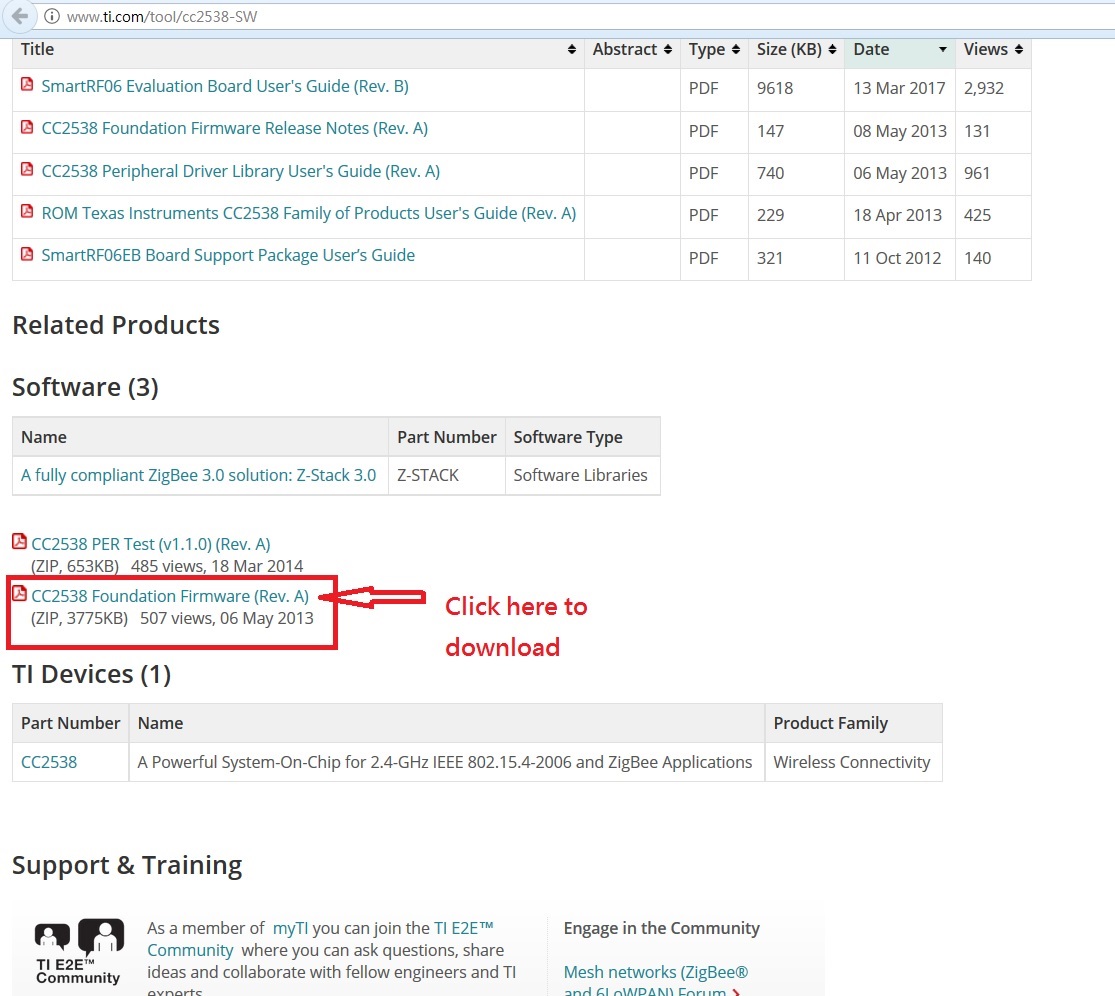

Hi everyone, I recently purchased the CC2538 and would like to use it with the USB connection without SmartRF06. Anyone can give me some indication?
You can give power from usb socket on CC2538EM. There is USB example in cc2538 foundation firmware. Download and install it, you will find examples under C:\Texas Instruments\cc2538_foundation_firmware_1_0_1_0\usblib
