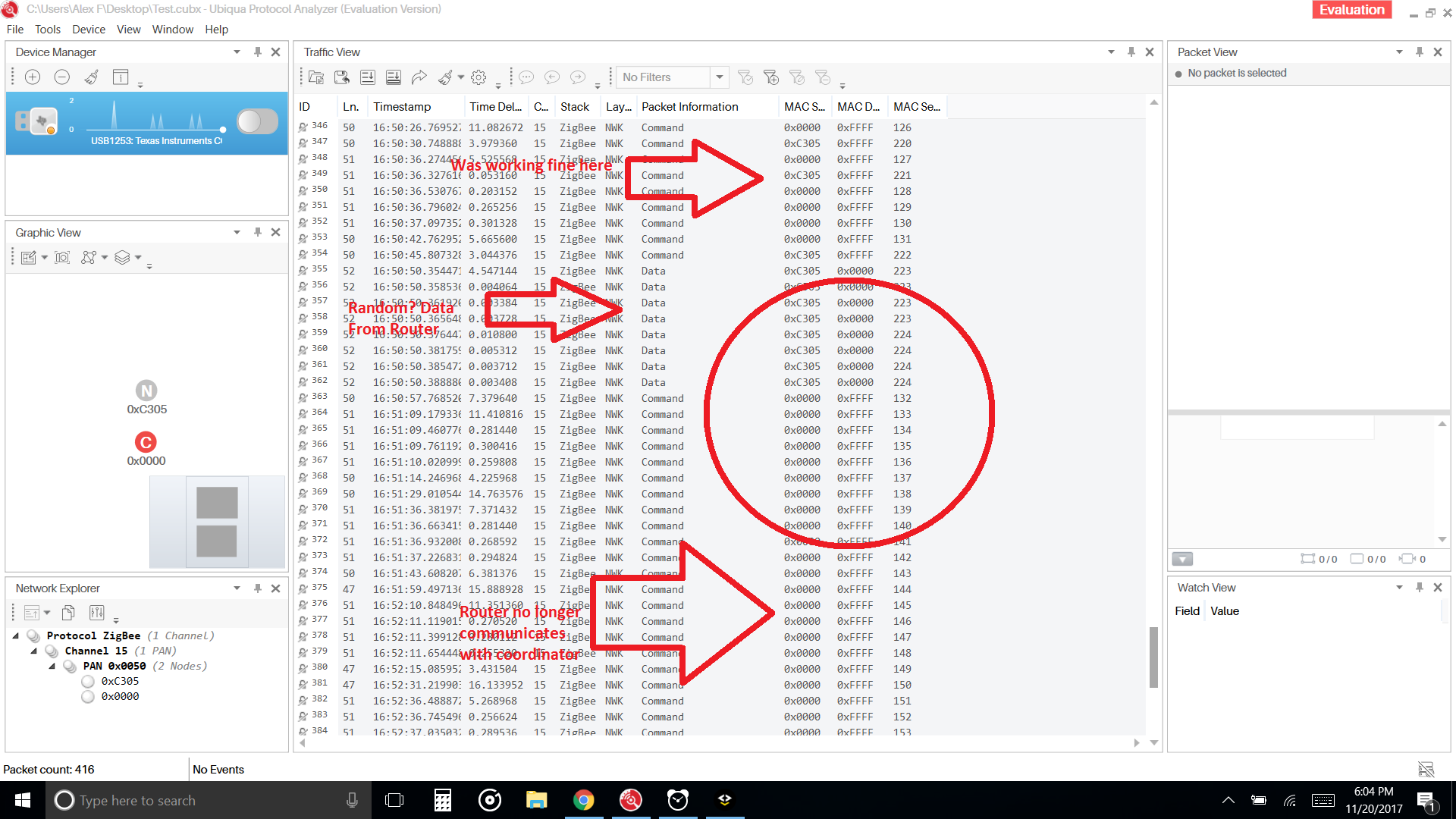

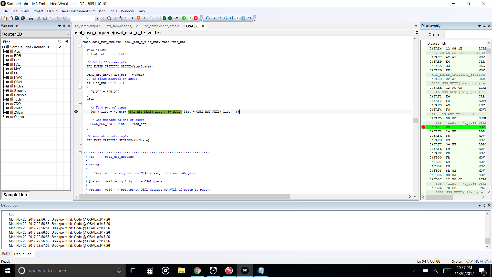

Hi. I've been having an issue when I leave the router device in SampleLight Z-Stack 3.0.1 (unmodified code) alone for 25-35 minutes, and then when I go to turn it on or off, the router no longer responds unless I re-power it again (just something to restart the program). So I think there is some timer going on in the code of the router that runs, and once time runs out, the router no longer responds. How might I fix this problem?
