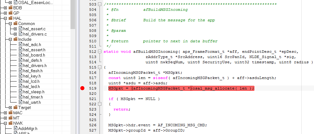

  • Set a breakpoint in afBuildMSGIncoming and see if it receives the data.
  • I have set breakpoint in afBuildMSGIncoming but result is nothing.

  • How about set a breakpoint in afIncomingData to see if it hits.
  • I did set breakpoint in afBuildMSGIncoming().
    I can't set brealpoint in afIncomingData().
  • Try to change Compiler optimization level to medium or low and test again.
  • I did try so but result is same.

  • I see no reason why you cannot set breakpoint in afIncomingData. Try to add EasenLock_PERIODIC_CLUSTERID into your in/out cluster list to test again.
  • YK sir.
    I did set breakpoint in afIncomingData() but nothing occur.
    And you said "Try to add EasenLock_PERIODIC_CLUSTERID into your in/out cluster list to test again.".
    Sorry,What is mean?
    I put it in my code that i send to you.

  • I suggest you to debug/trace into afBuildMSGIncoming
  • Hi YK Chen Sir.
    I did debug in afBuildMSGIncoming.
    Here, epDesc->task_id is 4503.Really EasenLock_TaskID is 9.
    Contents of MSGPkt is right.
    Piao
  • I am not sure why task id is wrong. I can only suggest you to keep debugging.
  • Hi YK sir.
    I have debug wrong method.
    I fix from "printf("AF INCOMING = %x\n",(epDesc->task_id));" to printf("AF INCOMING = %x\n",*(epDesc->task_id)); in afBuildMSGIncoming().
    I got again epDesc->task_id.
    Here, epDesc->task_id is 7.Really EasenLock_TaskID is 9.
    Piao
