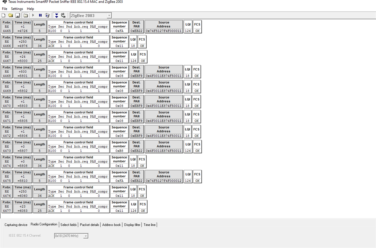

Hello everyone,
I have making a smart system by using cc2530 + RFX2401.
I am using Z-Stack3.0.1.
Here, POLL_RATE of end device is 1000 and use POWER_SAVING.
I have some issue in power consumption of end device.
1) When end device connect with coordinator,consumption current of end device is 13uA(Min) ~ 3mA(max).
2)When end device disconnect with coordinator, consumption current of end device is 13uA(Min) ~ 36mA(max).
I have test other RF products but those's current consumption is 1uA ~ 120uA.
Of course, these receive message from coordinator in standby status.
I want to reduce lowest standby current  of end device.
Please help me.
Thanks in advance.
