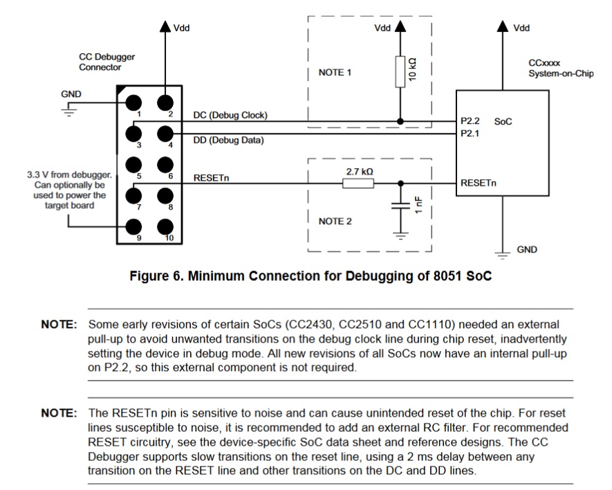

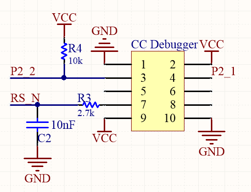

I design a board use CC2530 and i program with CC debugger. i want to test my load program block , what connect to CC Debugger.
I soldered the components necessary as in CC Debugger User' Guide, no more. Of course, i soldered IC CC2530.
My question is:
I just test my load program block. Do I need to solder the crystal, R301 and C401 as in the datasheet of the cc2530?
