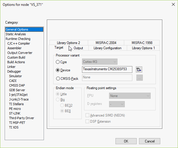

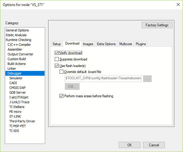

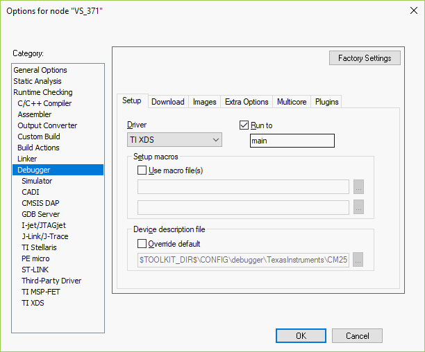

I'm trying to run ZStack SimpleLight and SimpleSwitch applications on custom board with CC2538SF53.
But when I download my binaries I get a lot of strange warnings from IAR like this:
Tue Dec 12, 2017 18:01:05: Warning:
Tue Dec 12, 2017 18:01:05: Verify error at address 0x0027D1E5, target byte: 0x02, byte in file: 0xFF
Tue Dec 12, 2017 18:01:05: Verify error at address 0x0027D1F0, target byte: 0x00, byte in file: 0xFF
Tue Dec 12, 2017 18:01:05: Verify error at address 0x0027D1F4, target byte: 0x34, byte in file: 0xFF
Tue Dec 12, 2017 18:01:05: Verify error at address 0x0027D1F5, target byte: 0x00, byte in file: 0xFF
Tue Dec 12, 2017 18:01:05: Verify error at address 0x0027D1F6, target byte: 0x01, byte in file: 0xFF
Tue Dec 12, 2017 18:01:05: Verify error at address 0x0027D1F7, target byte: 0x00, byte in file: 0xFF
Tue Dec 12, 2017 18:01:05: Verify error at address 0x0027D1F8, target byte: 0x07, byte in file: 0xFF
Tue Dec 12, 2017 18:01:05: Verify error at address 0x0027D1F9, target byte: 0x03, byte in file: 0xFF
What can be reason of such behaviour?
