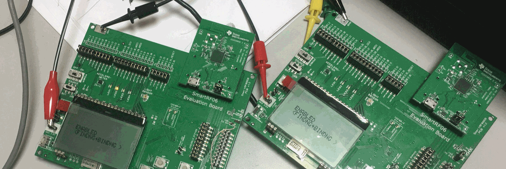

I'm trying to run ZStack SampleLight/SampleSwitch example.
I managed to compile and download applications without any error or warning, but I stuck with another problem: I can't toggle light remotely.
The sequence of my actions are:
1) download applications on my boards - SampleLight on the first and SampleSwitch on the second;

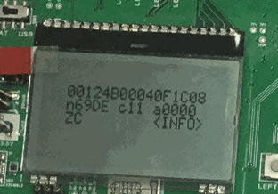

2) on the first board (SampleLight) I go to "Commission" menu and press "Select" button. Led2, Led3 and Led4 start blinking accordingly to user's guide;

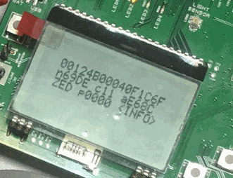

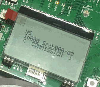

3) on the second board (SampleSwitch) I go to "Commission" menu and press "Select" button too;
Results of actions 1-3 are shown of the attached photos.
4) then on the second board (SampleSwitch) I go to "app menu", where I select "Toggle light", but LED1 on the first board don't blinks.
