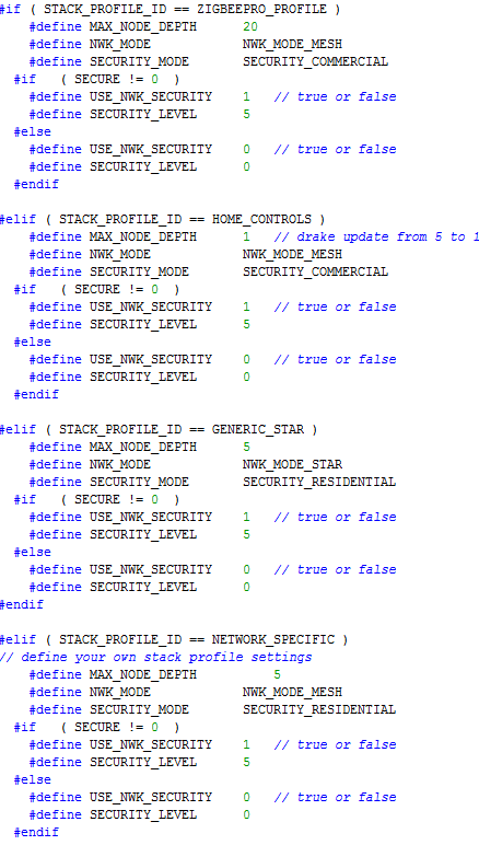

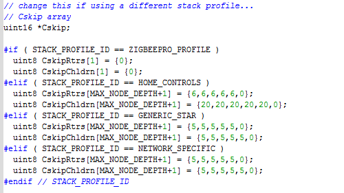

Part Number: CC2530
Dears,
In our system, pN :CC2530F256, Z-STACK-2.5.1a ,We make 60 child nodes connect to coordinator ,It works well,When more than 60,Some nodes cann't connect succesfully. the config code is as follow,
