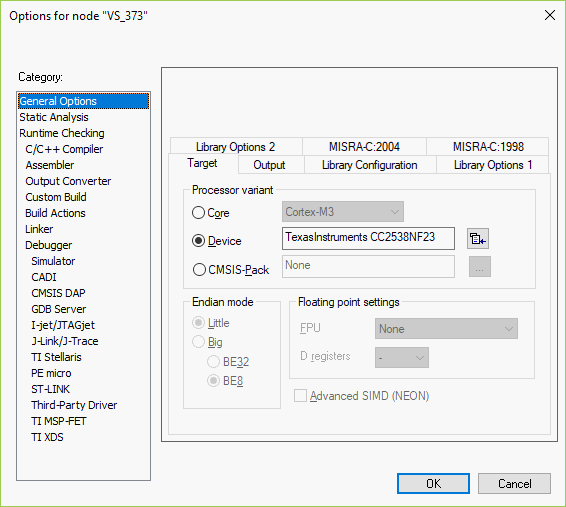

Hello.
I have question which is simular to some which has already been written on this forum.
I have a CC2538FN23 board on which my application runs.
I changed the target device in Target tab:
Also I changed ICF file to the attached: 6518.CC2538_NF23.rar
I changed hal_board_cfg.h  and defined THIS_IS_CC2538NF23:

But after turning off and turning on my device does not restore network connection.
With the same application I have no troubles on cc2538EM board, where cc2528sf53 is used.
What other settings I have to change to get NV_RESTORE option working?
