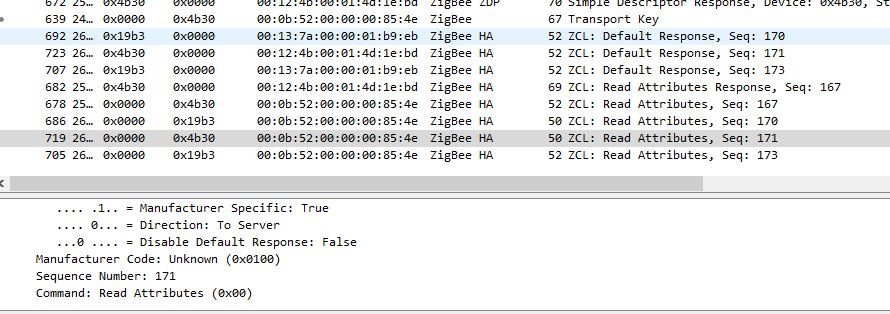

    the ZCL read attributes message in the #686 was sent from another device, as you see it in the Destination Address is 0x19b3. My device short address is 0x4b30.  I ordered the messages by info. As you see in the PIC below:
    As i told you i think that it is occurred  by effect of not sent ZCL Basic. It is reflected in the message # 719 (Read Attributes Seq 171) sent by Gateway, in the parameter Manufacturer Code Unknown.
    You see it detailed in the messages #719 and #723 in the file  My Device w Current ZBSERVER problem_2512_2017.zip

    I observed in the sniffer that i sent you the messages (Default Response) sent by my device in response to ZCL Attribute messages sent by Gateway. I explain those messages bellow:
    Seq. 167  – ZCL Command: Read Attributes, Model Identifier. ( my device was answer well and sent Read Attributes Response #682)
    Seq. 170  – ZCL Command: Read Attributes, Manufacturer Code: Unknown (0x0100) #686
    Seq. 171  – ZCL Command: Read Attributes, Manufacturer Code: Unknown (0x0105) #719
    Seq. 173  – ZCL Command: Read Attributes, Manufacturer Code: Unknown (0x0100) #705
    Default Response - # 692 (seq 170) , # 723 (seq. 171) , #707 (seq 173) , all those messages has a status: Unsupported Manufacturer General Command  and Manufacturer codes 0x0100 or 0x0105.
    My device reported via Default Response, in response to message Seq. 170 (ZCL Read Attributes w/ Cluster ID 0x0b04 - Electrical Measurement cluster), sent  Unsupported Manufacturer General Command (0x84). I think that after this response my device become silly.
    Would you can help me please, how to implement the Cluster Id 0x0b04 in my Cluster Libary?
    Maybe we have a problem also in my device code to understand the manufacturer codes 0x100 and 0x0105.
