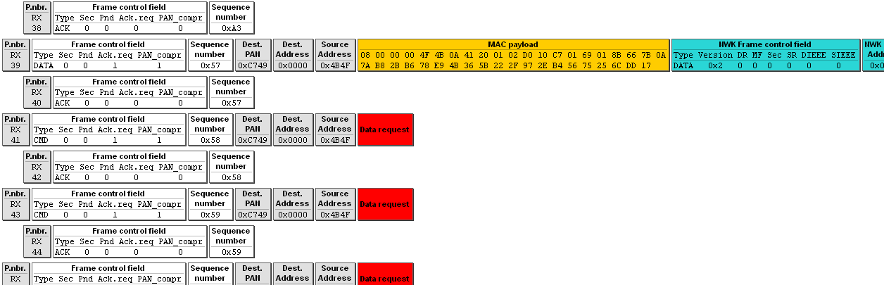

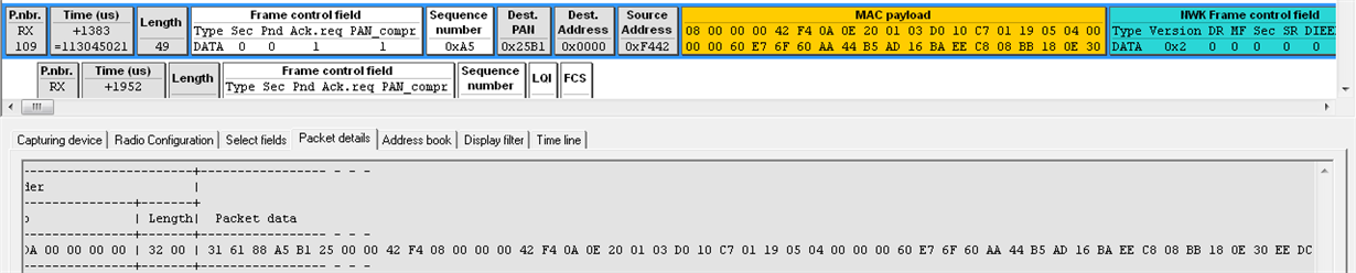

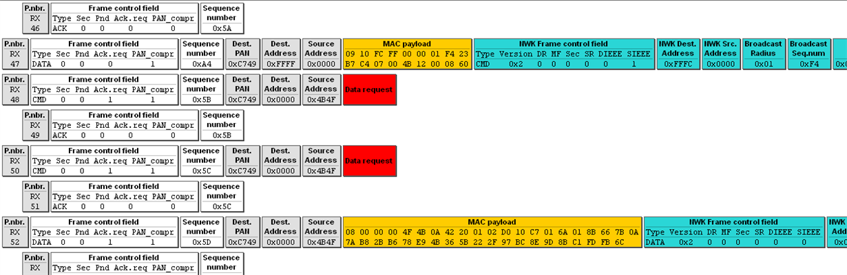

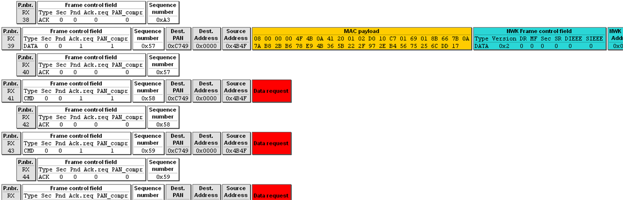

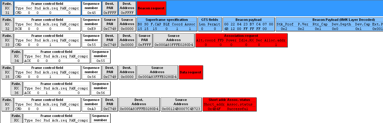

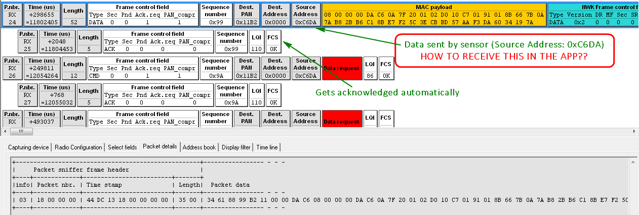

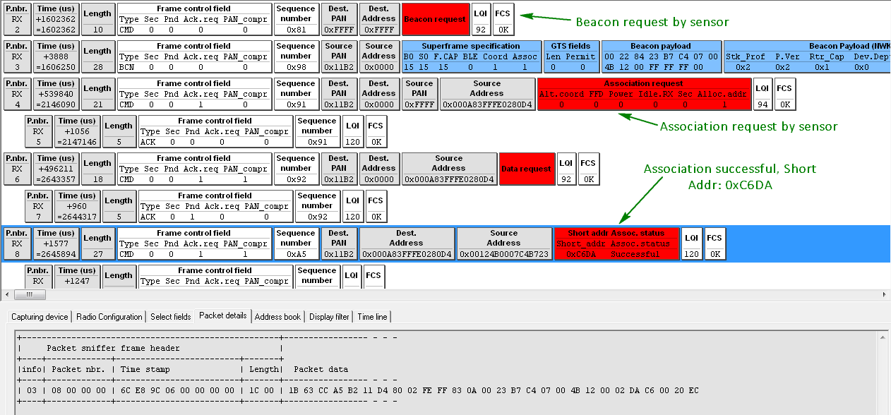

I'm able to start the coordinator, the senor gets associated as well. By using a sniffer I can also see the ping + acks and the data that the senor is sending. The problem is, I do not get any event when the sensor sends the data or the pings. I don't know how to receive the data being sent by the sensor. I have tried all the tricks I could come up with.
