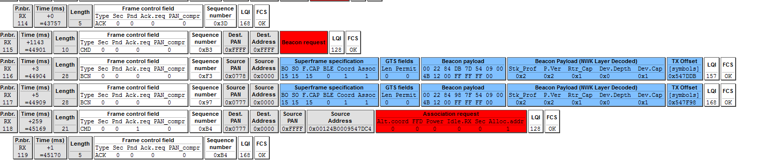

I power off one ZC and one end device only , and I did captured sniffer log.
End device have trouble in joining can't join on ZC.
Would you please explain to me for this?

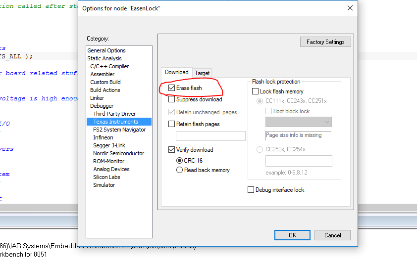

I tried again by using flash programmer but result is equal.
Or ZC have issue?
I attached sniffer log file.
