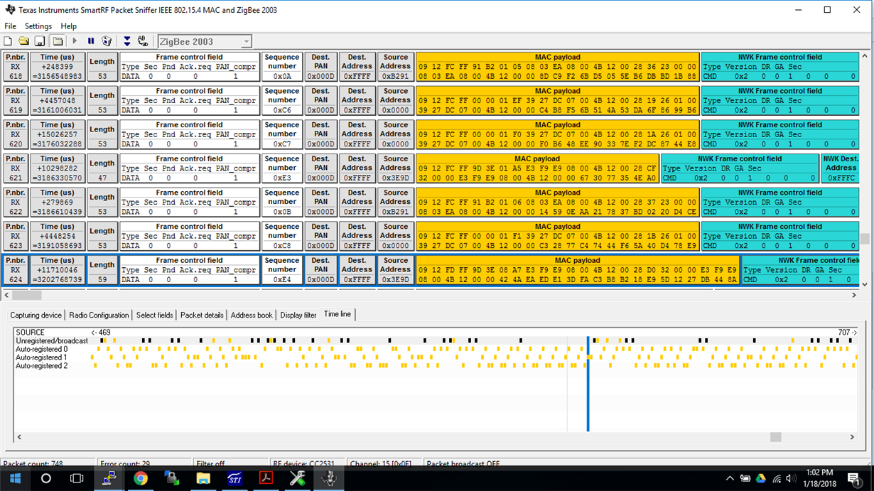

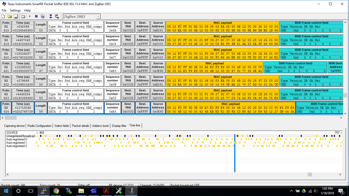

CC2530: end device stops receiving commands from coordinator after OTA fails
Part Number: CC2530
Other Parts Discussed in Thread: Z-STACK
following observation are made:
- During ota updated and after successful completion:
communication between end device and coordinator is working fine both too and fro
- when ota fails:
coordinator receives messages from end device
but end device is not receiving msgs from the coordinator.
- if the device is hard reset after ota failure
operation goes back to normal
