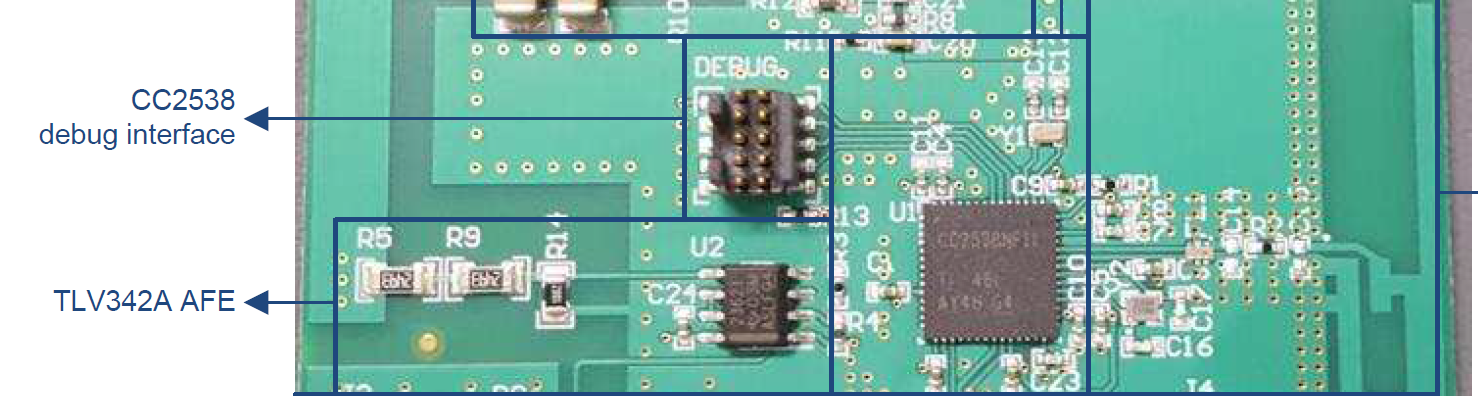

I have a custom CC2538 design, which has a 10 pin debug connector.
Can i program the chip using CC2538 SmartRF06 EB?.
Is the below configuration correct for this?
1.Unmount J503.
2.Mount P408.
3.Connect the chip's 10 pin connector to EB's 10 pin arm cortex debug connector.
4.Self power the chip.
