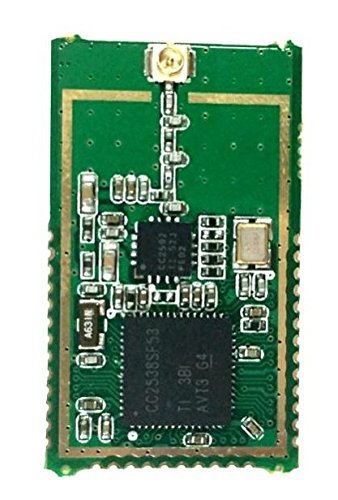

I have a CC2538 breakout board. Something like this:
I am trying to figure out how to program it. I am using IAR. I read that Segger J Link can be used to program this thing. Mine has this pinout:
This is the first time I am using JTAG. I have made these connections: VTREF to 3.3V, GND, TDI, TMS, TCK, TDO, Reset to reset pin of cc2538. However I get an error message in IAR saying: Requested 2018 bytes from MCU. Received 0 bytes.
Is it possible to program CC2538 using Jlink? Should I buy some different programmer?
