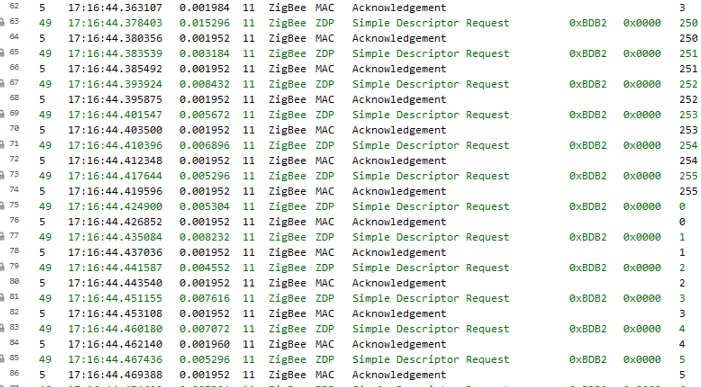

Hello everyone,
I have recently purchased four CC2530 (https://www.waveshare.com/wiki/Core2530basics. Using the GenericApp sample application and the instructions given in documents i'm able to setup a coordinator and end device. However, I'm unable to setup a data link between the end device and coordinator and i don't understand the basic setup procedure given in other examples.
Request you expert advice to get my project going.
  • Are you sure your device joins coordinator? And, how do you send message between device and coordinator?
  • Yes, the end device joins the coordinator. Please see below the screenshot of ubiqua protocol analyzer for reference. You can find the end device joins coordinator.
    I planning to send a temperature data in a unsigned integer format to the coordinator at an periodic interval of 15 minutes.
  • Can you please post the *.cubx file? Also, you probably need to enter this key as a Trust Center Link Key in the Ubiqua Key Chain:
    5a 69 67 62 65 65 41 6c 6c 69 61 6e 63 65 30 39
  • If you intend to send temperature data, I suggest you to use SampleTemperatureSensor and SampleTheomostate example.
  • Thank you Jason. Let me add Trust Center Link key and capture the cubx file and post it soon.
  • You can attach your cubx file of the screenshot.
  • Yes, the device 0x3315 joins coordinator correctly. I see the device sends a proprietary message to coordinator on Packet number 38. Is that packe sent by you?
  • No, I'm not sending any message to coordinator.
    Let me share some additional information on the setup i have in my lab. I use ZB502 () development board for my experiment. For software, i use  GenericApp example code from Z-Stack samples. To handle Key1 press i modified hal_key.c (to capture Key1 press) and zcl_genericapp.c (to run commissioning procedure on Key1 press). There is no update made on other files. My goal is first make the End Device to find Coordinator (which i'm able to do so). Next i want to start add logic to send temperature sensor detail to the coordinator at an regular interval.
    Note: Attached the hal_key and zcl_genericapp for your view.

  • There must be something wrong in your finding and binding. Do you start finding and binding about the same time from both coordinator and device to make them binding.
  • I would say yes. I start both coordinator and and end device at the same time but i start the commissioning process on coordinator first and then the end device. Is there a way to get finding and binding status at coordinator end? if so i can wait until it completes and then start the end device commissioning process.
    Also from my previous log posted i see multiple Simple Descriptor Request from End Device to Coordinator where there is a acknowledgement (img1) after which there are multiple Simple Descriptor Request for which there are no acknowledgment. After this the end device rejoin the coordinator. Is this a normal behavior? What is the significance of Simple Descriptor Request?
    img1 --
    img2 --
