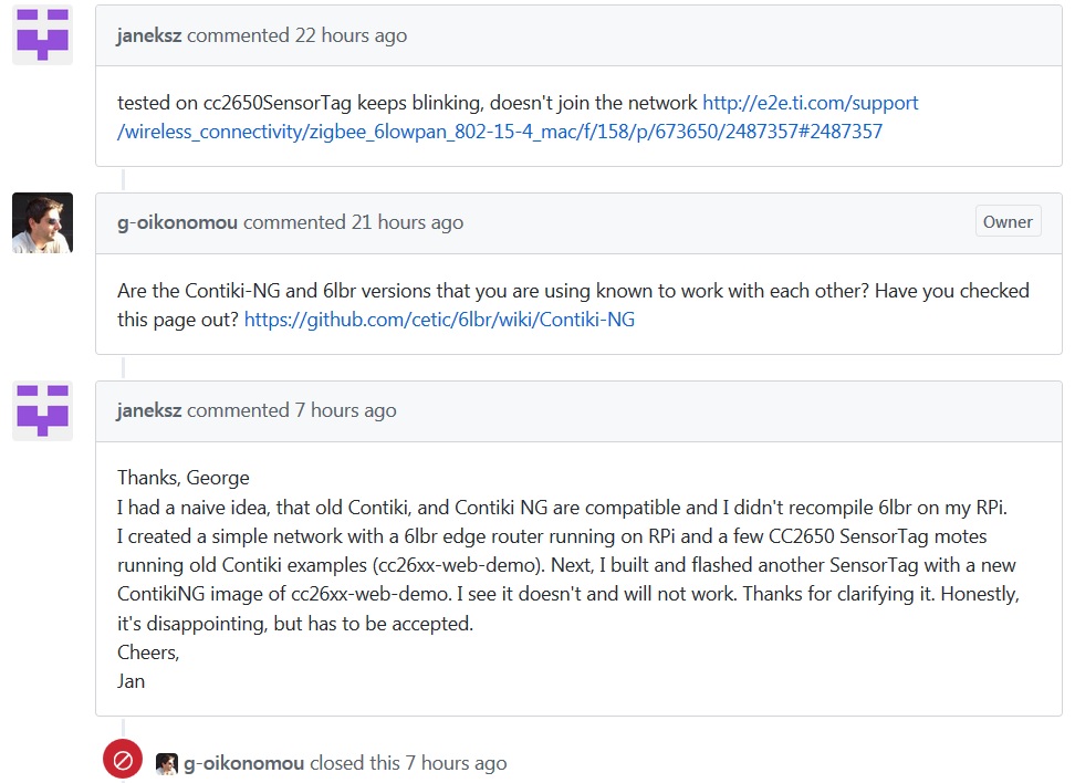

Trying to compile Contiki NG for CC2650 Launchpad + CC2650 Sensortag(s) + 6LBR and unable to make them work.
Same hardware works when compiled using old Contiki.

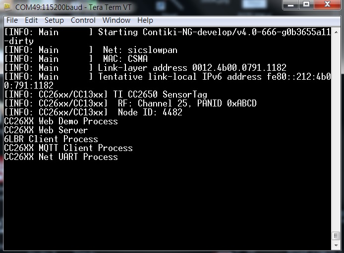

- mote problem, after flushing cc26xx webdemo to sensortag I have
[INFO: Main      ] Starting Contiki-NG-develop/v4.0-656-g6d57dd0-dirty
[INFO: Main      ]  Net: sicslowpan
[INFO: Main      ]  MAC: CSMA
[INFO: Main      ] Link-layer address b0b4.48ff.fec8.0c03
[INFO: Main      ] Tentative link-local IPv6 address fe80::b2b4:48ff:fec8:c03
[INFO: CC26xx/CC13xx] TI CC2650 SensorTag
[INFO: CC26xx/CC13xx]  RF: Channel 25, PANID 0x0000
[INFO: CC26xx/CC13xx]  Node ID: 0
CC26XX Web Demo Process
CC26XX Web Server
CC26XX CoAP Server
6LBR Client Process
CC26XX MQTT Client Process
again despite changing PANID in project-conf.h to 0xABCD it remain 0x0000
MAIN PROBLEM,
Everything together doesn't work, no network formed
When build on old Contiki, works OK
Someone can give me a hint?
