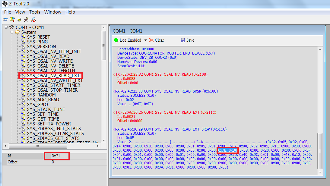

    Second Quesion
    While I am sending Util_Get_NV
    <TX>11:47:13.91 COM15 UTIL_GET_NV_INFO (0x2701)
    <RX>11:47:13.96 COM15 UTIL_GET_NV_INFO_RESPONSE (0x6701)
    Status: 8 (0x8)
    IEEEAddress: 0x00124B000FF381CC
    ScanChannels: NONE (0x0)
    PanID: 0x0000
    SecurityLevel: 0x40
    PreConfigKey: ................ (0x00, 0x90, 0x11, 0xFF, 0x01, 0x03, 0x05, 0x07, 0x09, 0x0B, 0x0D, 0x0F, 0x00, 0x02, 0x04, 0x06)
    whyis this not shaowing its PANID and Scan Channels ?
    How can I get it ?
    This time my PAn ID is (0x1190) channel (0xD)
    Please suggest your inputs....
  • You should read _NIB from NV to get the PAN ID. The NV ID of PAN ID is 0x21 and you should check 34th and 35th bytes to get PAN ID in response. You can get channel by 23th bytes in _NIB NV response.
  • Okay .Thanks This is working......
    Can I get each byte detail in the same packet ?
  • Yes, it maps to _NIB.
