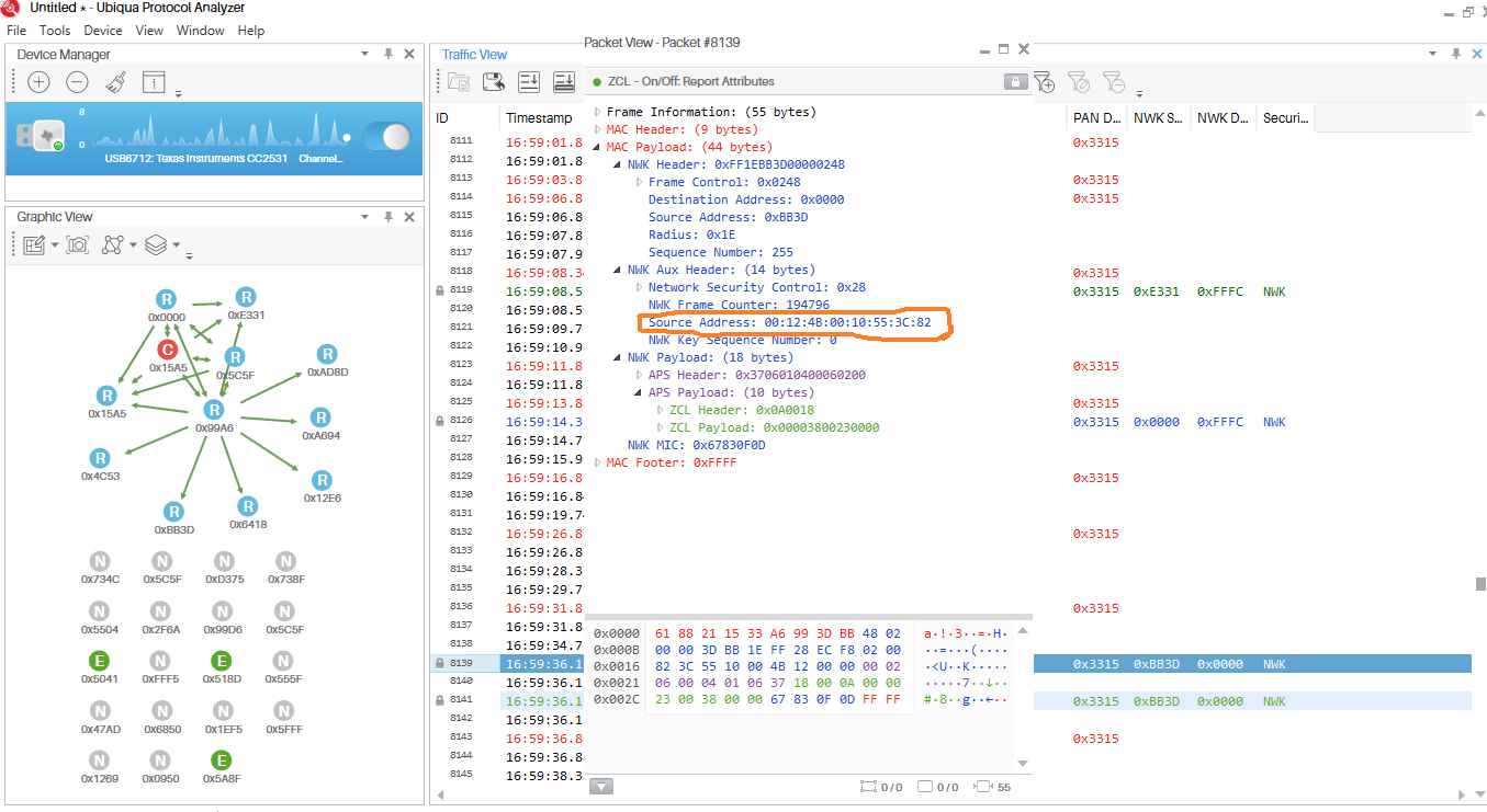

CC2650: Linux gateway not able to resolve mac address of incoming report command from end devices and routers
Guru 14820 points
Part Number: CC2650
Other Parts Discussed in Thread: CC2538-CC2592EMK, , Z-STACK
I am using cc2650 as ZED and cc2538-cc2592emk as ZR and Raspberypi+CC2538-cc2592emk(ZNP)
I am running z-stack home Linux gateway on raspberry-pi.
I have around 60 ZED and 5 routers in the network.
all routers and zed are sending data(report command) to getaway but gateway is not able to resolve the mac address from any report command. It is displaying 00 as mac address.
